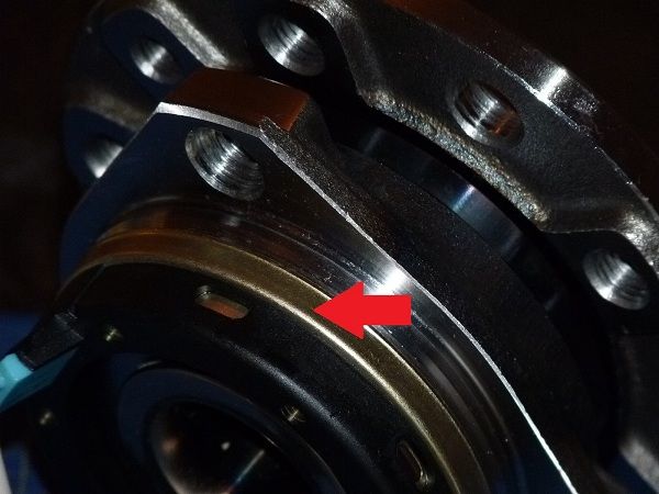

BTW.. Be careful with some of the later pattern-part hubs (eg. Ebay specials)
The original hub bearing units use double-row full contact ball bearings with the inner races folded over during production and can be run without a center bolt or drive axle as the bearing is self-contained and can't 'go' anywhere, however it seems that various 'no-name' hubs that are sold by generic vendors are now actually comprised of a traditional tapered-roller bearing inside the housing and a pressed in flange. (aka. an 'old skool' setup that's much cheaper to manufacture)
In itself this does not have to be a problem as far as proper functioning goes, but for the VX case the issue is that these types of bearings can NOT be run without clamping the bearing down laterally. So in these cars the front hubs MUST use the M16 through-bolt clamping setup (rears of course will already have the driveshaft nut clamping it down). If this is not done then the bearing can and will dis-integrate quite rapidly.
Not a problem on reasonable 'brand' bearing packs as they will have copied/licensed the original sealed and fixed ball-bearing design, but un-branded (aka. Ebay-special or chinese knockoff) bearing packs can be something to keep in mind.
Bye, Arno.
Can you tell which type this hub is?
