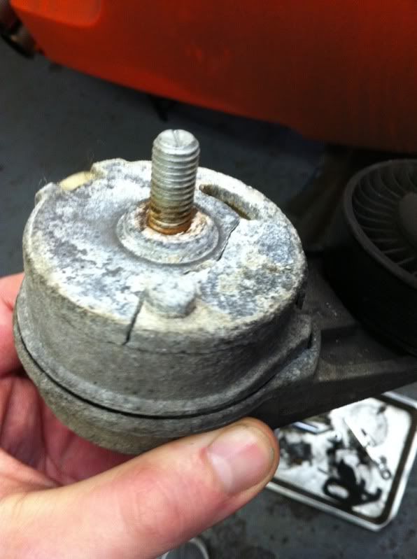

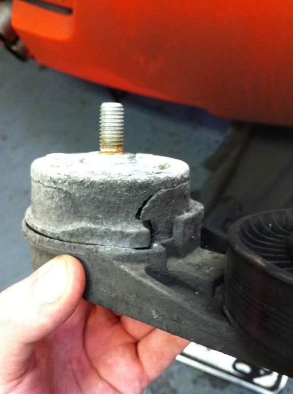

A couple of things that emerged during the change; my aux drive belt tensioner looked like this:
Benny diagnosed water damage...well to be more precise, water had got in and then frozen. So after a bit of umming and arrring and a some kindly made phone calls, a new part was found.............across the road! hahaha! Benny said "See that building over there.....it's there" So off I trotted. 5mins and £50.50 later I had a new tensioner - phew! just as well too cos when Benny tapped the old one on the floor to push the bolt through, it fell apart!

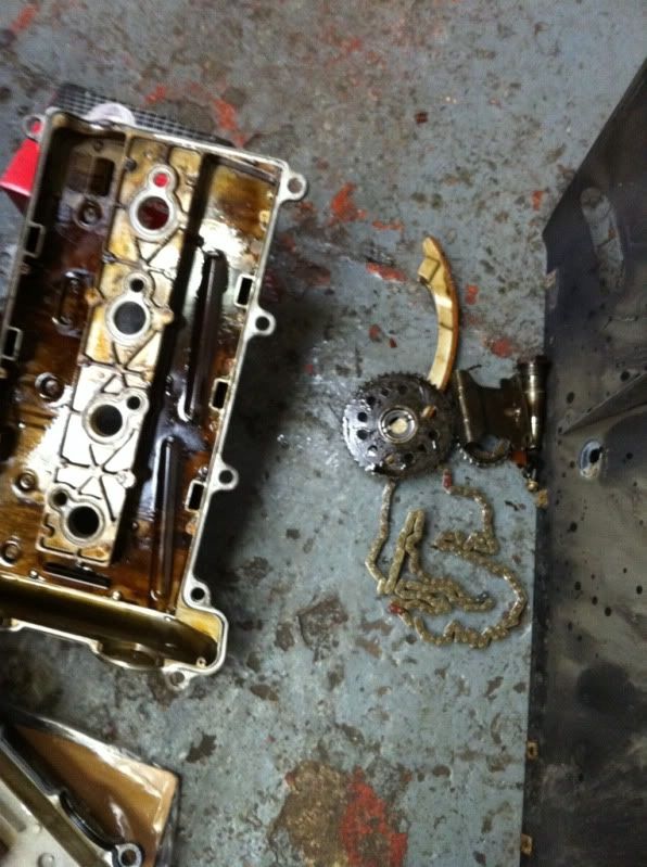

Old bits:

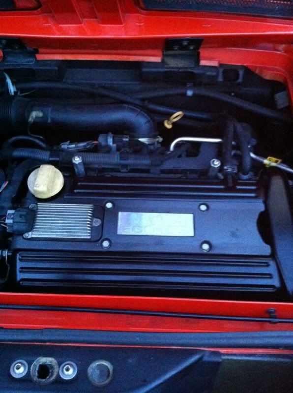

Here is a quick pic that I took when I got home (we fitted the powder coated rocker cover I had)
