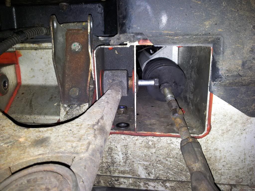

Any tips for removal of the front upper wishbone pivot bolt (rearmost) - I can't get it past the steering arm even with the gaiter pushed back?
#15 FLD
Posted 12 January 2013 - 11:54 AM
Turn the rack onto full lock.
#16 hairy
hairy
    Moonlander
  • 6,036 posts
Posted 12 January 2013 - 01:04 PM
thanks Matt, I always get stuck on the obvious things thumbsup
