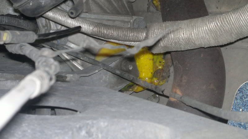

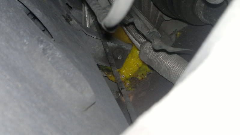

Here is what I think of mine:
And:
Oh they are just sooo amazing melted all over my undertrays...... thumbsdown
The turbo engine bay is larger for a reason and that's part of it.
Aint it just the lid that is larger? I have no idea to be honest, im not arguing, where exactly is it bigger where it would affect the exhaust? :mellow:
tbh the ruber next to it is fine!...... polyurethane = fail.
Edited by chrisgold, 19 July 2011 - 08:24 PM.
#16 techieboy
Posted 19 July 2011 - 08:43 PM
Nope, not just the engine cover. More space between the engine and the boot bulkhead as well. That's why the turbo boot is a few inches shallower than the NA's and why Lotus had to increase the size of the boot lid vents when they fitted the ears to allow the additional cooling air to escape.

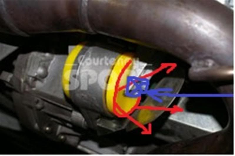

I have been educated :rolleyes:
I still think that the mounts are an epic fail tho, they dont even fit properly in the first place, they bow out around the edges.....
Like so (excuse my ubber paint skills) even in the freshly fitted courtenay pic they are bowing out.
Soon as pressure is applied to the original mount it squeezes the powerflex ones out round the edges (the edges being the only bit that does anything)...
Edited by chrisgold, 20 July 2011 - 05:39 PM.

When not moving, I would have thought that the load is carried by the part of the mount/insert that is clamped by the mount bracket. When using on front and rear, you would have thought that where one is loaded wrongly from the perspective of the part being effective, that the other would be handling the opposing force in the desired way? I must say, on balance, I am glad I did this. The car does feel better during gearchange somehow. Probably just placibo :rolleyes: :)
