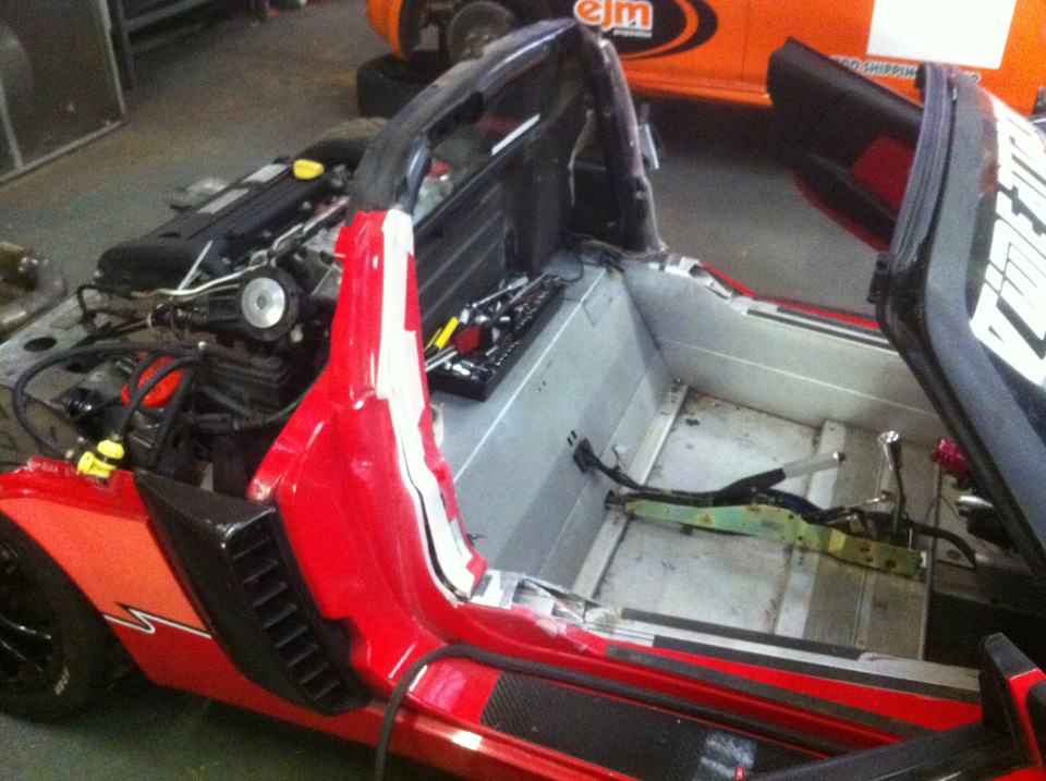

Started stripping for the cage...

OMG, you have to have the sills apart (down the drivers shoulder area) No way back now.

I'm sure the installs I've seen don't have the B pillar clam cut away like that?

You have to cut it approx up to the shoulders level to get the OE one out Then as the door lock is bolted on it too, depending how you deal with it, it's easier to cut it that much (but can be done without)

I think thats how TMS fitted most of theirs, the other option is to remove the entire bulkhead section :huh:

Mine is cut too. Who care's it's only fibre glass!!
