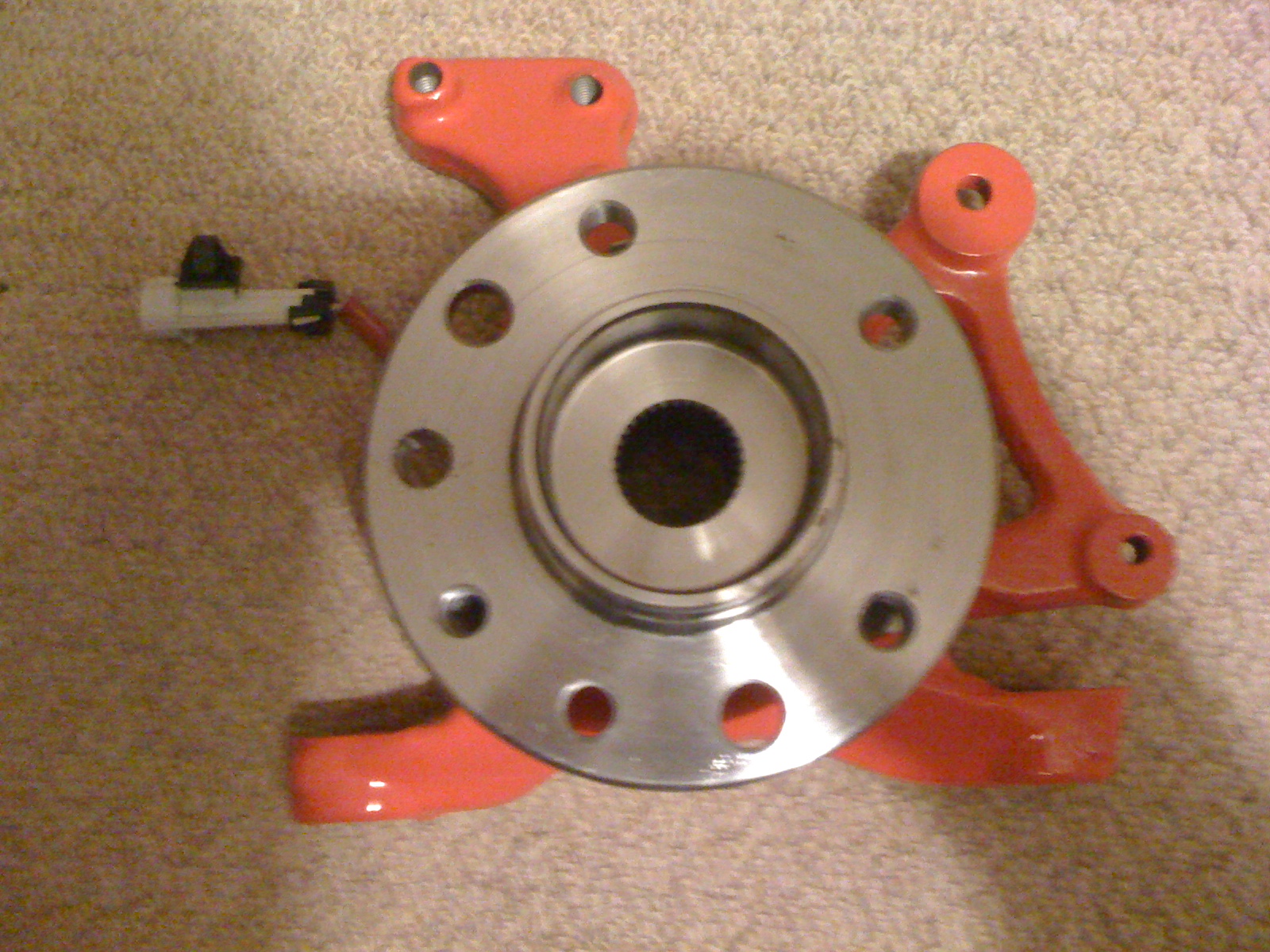

Wheel bearings arrived today, lovely shiny and new from Autovaux. Came with the wrong bolts though.
Lovely fitted to the hub.

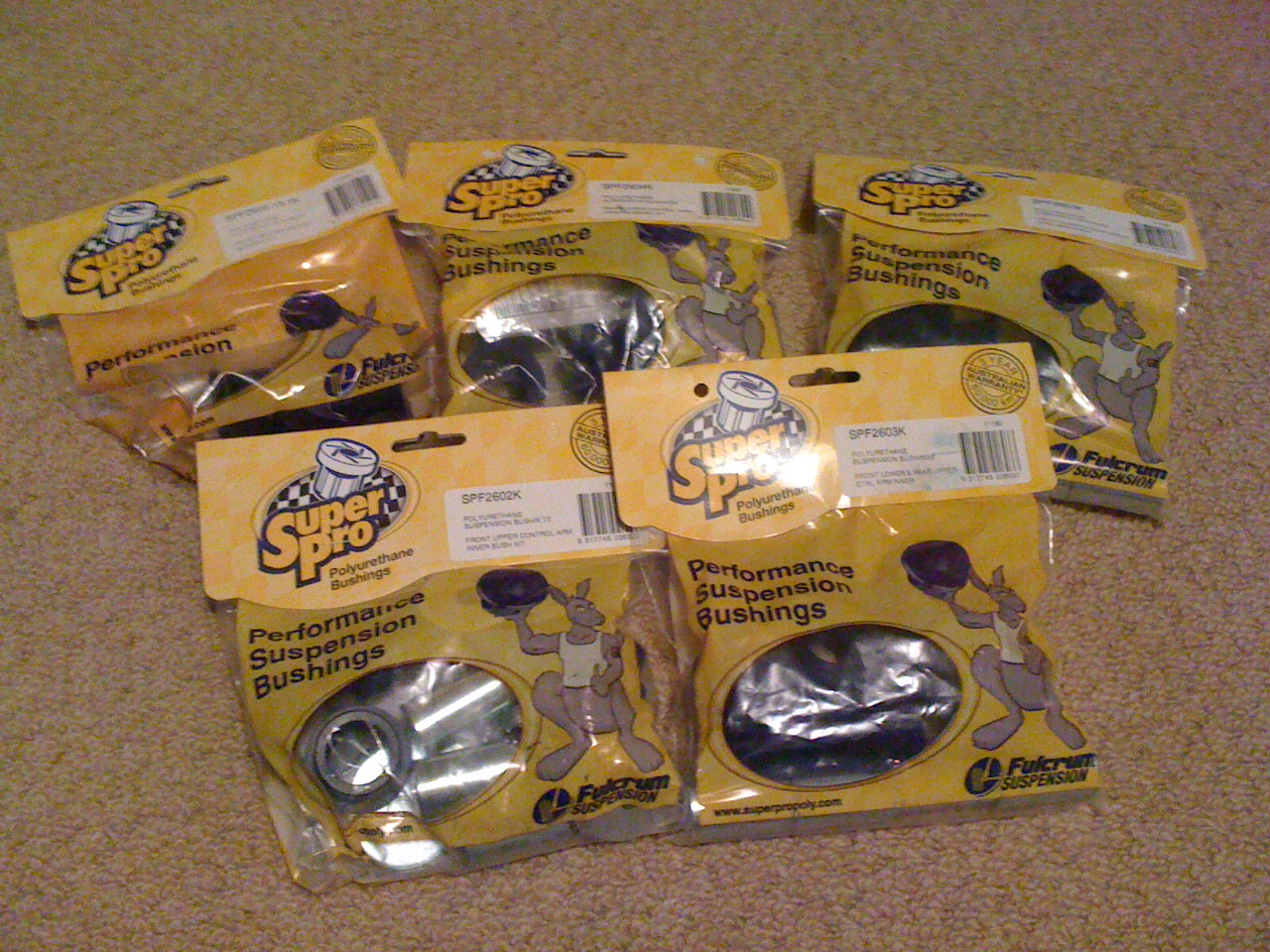

Posted 21 December 2011 - 10:01 PM
New bushes arrived today. Nowt wrong with the old ones but after 40,000 miles I thought it good to get new ones.

Posted 21 December 2011 - 10:10 PM
Cliffie what grease is it that comes with the super pro I have some nice new wishbones and need to swap my super pro bushes over ? Looking good by the way you are going to town on the old girl .will you be stage 3 by then as well ?
#150 Mike (Cliffie)
  • 13,354 posts
Posted 21 December 2011 - 10:17 PM
That's the plan Lee. After the miles she has seen, it is only fair to spruce her up a bit and treat her to new bits. Total suspension overhaul with powder coated bits, new rear subframe, new engine to Stage 3, roll cage, body mods as seen and interior sorted. I have some grease and spare new bushes here dude so you can have those.

Posted 22 December 2011 - 09:09 PM
Lol, it's just lithium grease you can get some in halfords :) Mike watch your brake caliper when you mount if the hub as you've coated the face of the hub so will have moved the caliper laterally my a mill or so... If you're fitting cooling aswel is might be an issue :) Car looks superb though mate, I can't wait to see it when it's finished! I will be jealous though!!!!
#158 Mike (Cliffie)
  • 13,354 posts
Posted 23 December 2011 - 09:08 AM
I had thought of that but as these are the rears and use the sliding caliper I am OK, will cause havoc on the fronts though so will watch out for that when I get them done.
I doudt you will be jealous baring in mind you and your VXare a major part of the inspiration to get this thing going.
