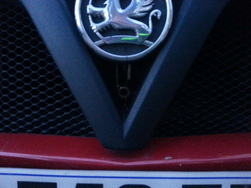

#39 mark moyz
mark moyz
  • 643 posts
  • Location:lancs
  • Interests:Redundancy demotions pay cuts 0 hours contracts employment shaftings
Posted 19 June 2013 - 09:22 PM
