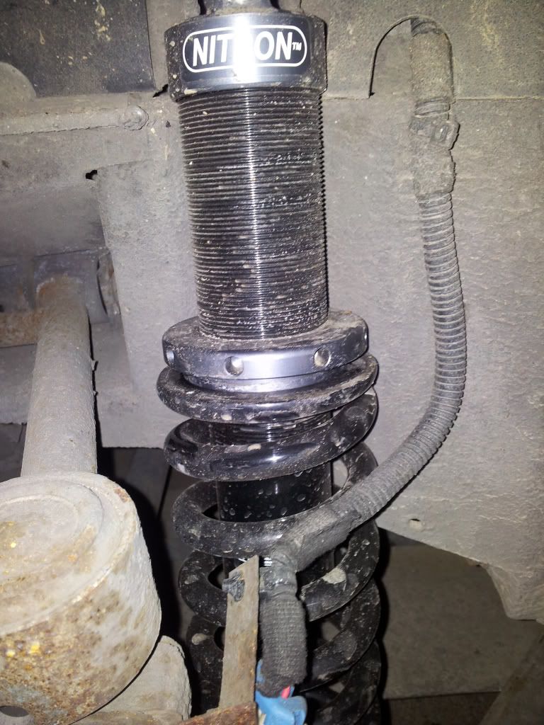

My nitrons are almost brand new (only 200 miles old) but when I jacked the rear up today, to have a look at the brake pads, I noticed that the spring was loose on the shock with a gap of 1cm+ between the spring and the adjusting collar. I would have expected a helper spring to be included to avoid the spring rattling around when going over pot holes and speed bumps (and I do have noisy suspension in exactly these situations) I'm going to adjust the collars to remove the gap (raising the ride height) to see if it helps quieten it down over bumps but was wondering if anyone else had added helper springs? Ride height is currently 115 123.

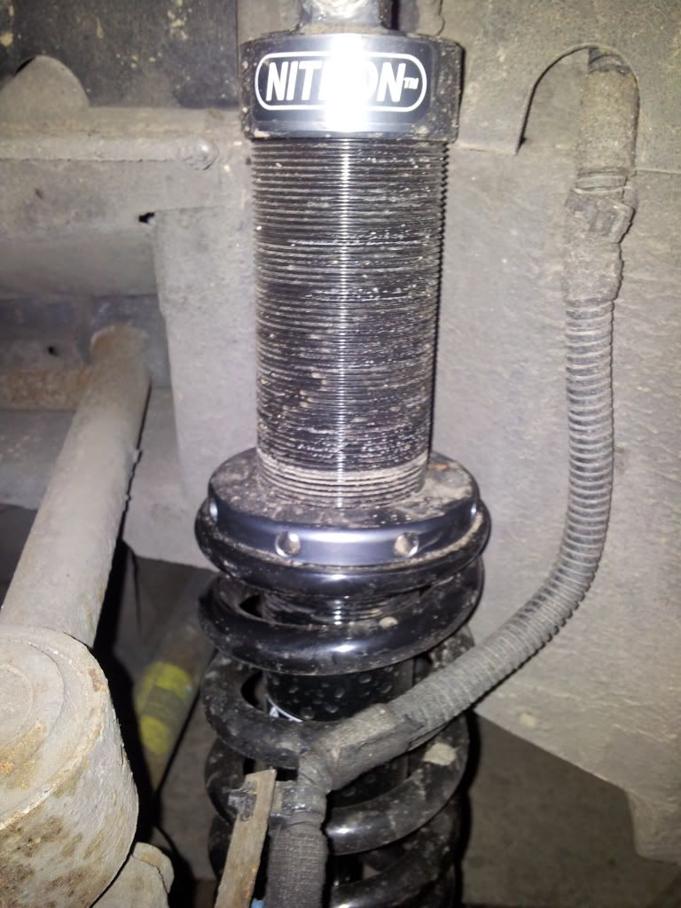

Right, increased the preload this evening so that there is slight pressure in the springs and went out for a drive.
The car still rattles but subjectively I thinks it's better over the larger pot holes. Either way I'm much happier having the springs under some pressure at full extension - as per nitrons own instructions.
Before:
After:
#11 Exmantaa
  • 3,982 posts
Posted 04 February 2013 - 11:18 PM
You will have some more bump travel now, so it should go a bit better over the potholes
