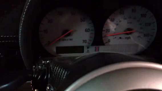

#12 Hark
Hark
  • 3,443 posts
  • Location:West Midlands
Posted 22 July 2013 - 05:57 PM
Not sure if this will work, here's a link to a video of the dash on startup. http://i243.photobuc...zpseb33c3c5.mp4

#14 jules_s
Posted 22 July 2013 - 08:25 PM
That doesn't look great :(
Have you tried re-setting the stack yet?
http://www.vx220.org...ack-dash-reset/
#15 Hark
Hark
  • 3,443 posts
Posted 22 July 2013 - 08:44 PM
Stack reset didn't do anything, relays all look secure.
Presume that leaves the stack or the loom...
