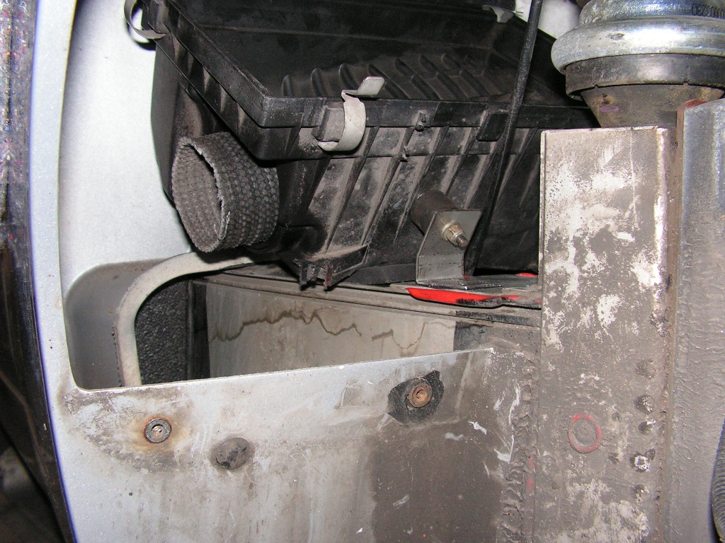

Standard air box flows plenty but no way to fit it without moving the ecu, I've tried.
When the new engine and ECU finally go in my car, I'll definitely be relocating the ecu to get a modded NA airbox (which is actually better than the turdo's) back in the car and hope to lose most of the supercharger whine. Especially if I fit a slightly larger pulley.
Try harder... :happy:
It fits, but needs relocation and fabbing some new mounts.
Ow, and the important bit: No Whine!
(He wanted an SC  conversion, but as quiet as possible => Airbox + VXT backbox. thumbsup  thumbsup )
Is that with the bottom half of the standard box in place too?  I use the standard box but the bottom is butchered to make it fit, filter needs cleaning regularlary though as it is so exposed.

^^ off course the complete filter box unit with bottom. This is the new bottom mount (2K glued on frame rail):
And I re-used the modified NA intake tube for the perfect OEM look. :happy: :
If fits... just... And filter change is a bit of work now, but NO WHINE! :rolleyes:
