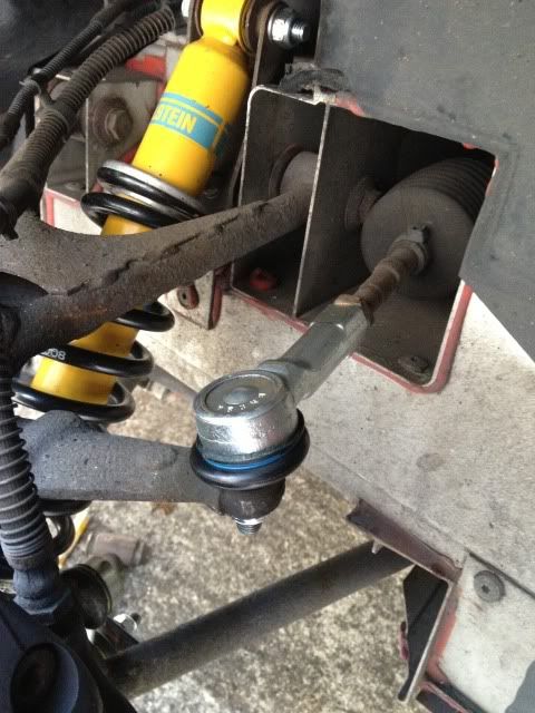

It won't make a blind bit of difference. Spend the money on your standalone ECU. If you were to get this kit you'd want to have the rear uprights machined down as well. Then you'd need a completely new geo and camber set up. It'll eat your inner tyre tread and for the money won't give you much benefit per £.
what he said.  For most its a box ticking / pub talk exercise but if your money is burning a hole in your pocket got for it.  It wont do anything that you'll notice as adverse.
yea, right.
OK, back to first principals..
the reason they exist is twofold.
1) to enable the use of more camber without having to get the uprights machined
2) to have the ability to set the bump-steer for any combination of ride hight/caster/rack hight.
Yes, you can achieve the same goals with machining, moving the rack about & bending the steering arms, but it's a lot harder and less precise.
Yes, bump is just as relevant on the road as the track, more so when you consider that your usually dealing with much more wheel-travel.
All that said, they are really only needed if you have moved into a problem area in the first place, ie, beyond the limits of the std setup, ie, ride hight outside of usual limits or a change in front wheel/tyre setup.
downside to them is they have to be setup right, just bolting them on usually makes it worse as most places don't have a clue what they are trying to setup, the description is also a bit misleading, you need bump-steer, the trick is to get it right, get it wrong and the car not only handles like a pig, it can be positively dangerous.
Lastly, for camber to wear out the front tyres unevenly requires a shed load of camber, like 4-5+ degrees, something I doubt most would get into.

Anything really, from a fast bump/rise in the road to a pot hole. Anything that makes the suspension move, because if your bump steer is set wrong then the car will change direction as the suspension travels.

for the front , its approx 1mm toe-out for 25mm of bump
having said that, the compliance and condition of the bushes will change that
