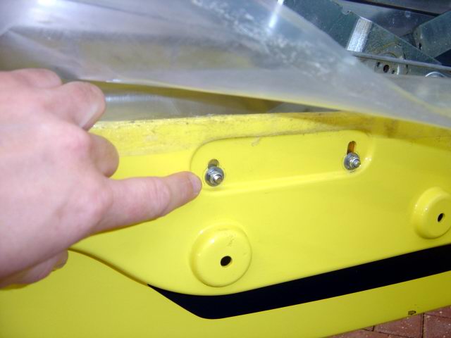

Also found this old post.  Might help:
You can also adjust the height at the front and back by faffing around with these screws, although the adjustment doesn't really work in a logical way, so you really do need to try a few settings before you put the door back together...
