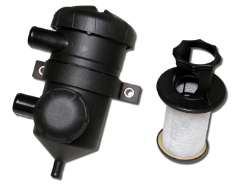

Or get yourself a Pro Vent 200
If Lingenfelter use them on modified ye olde pushrod GM V8s then they must be good!
