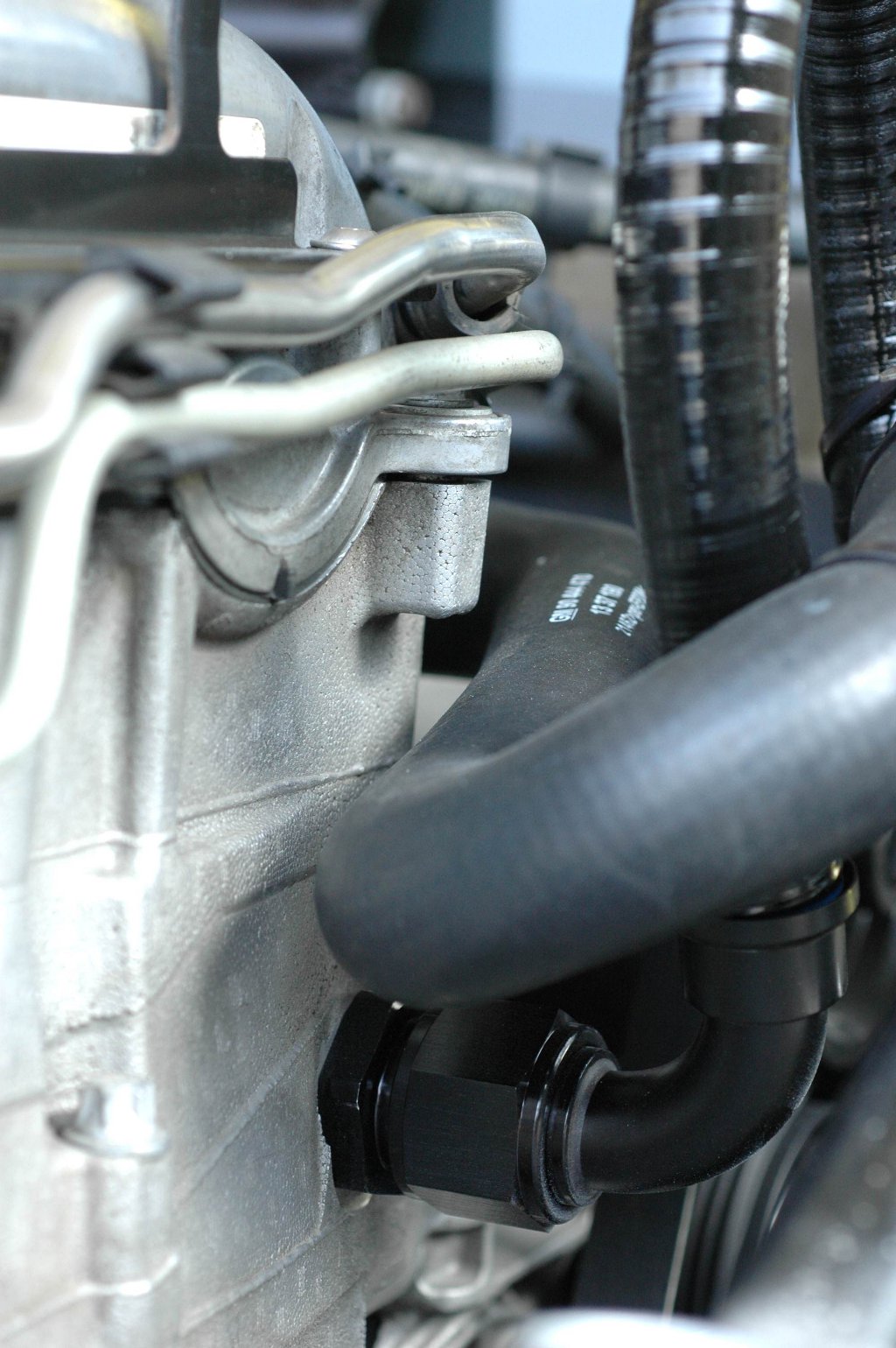

This is my  setup for breather, 90°  AN-12 barb for 3/4 hose  in place of the head timing cover plug, both the cam cover hose and this 3/4 hose goes to an oil catch can and then out of the catch can another 3/4 hose to a little filter placed on the undertray.
With this setup the engine is free breathing, no more blow-by pressure build up is allowed.

I 've made this mod only 1 month ago, since then no oil in the catch can, i think need longer time  to build up some oil ....
The plug thread is a standard setrab oil cooler type, M22x1,5, so  is plenty all around of adapter M22x1,5 to AN-12 to get the oily crap out!
