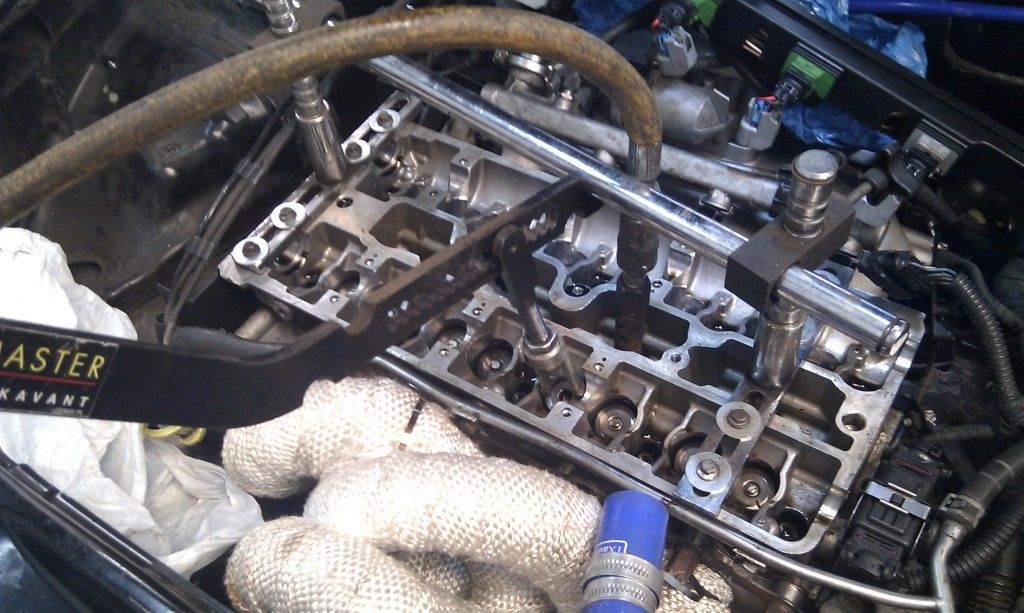

#14 siztenboots
Posted 20 October 2014 - 12:21 PM
you don't have to take the head off to replace them, it can be done in situ
#15 mbes2
mbes2
    Someone say Plasti Dip?
  • 8,516 posts
  • Location:Feering, Essex
    "Yes, I built it"
Posted 20 October 2014 - 12:30 PM
Image from google
