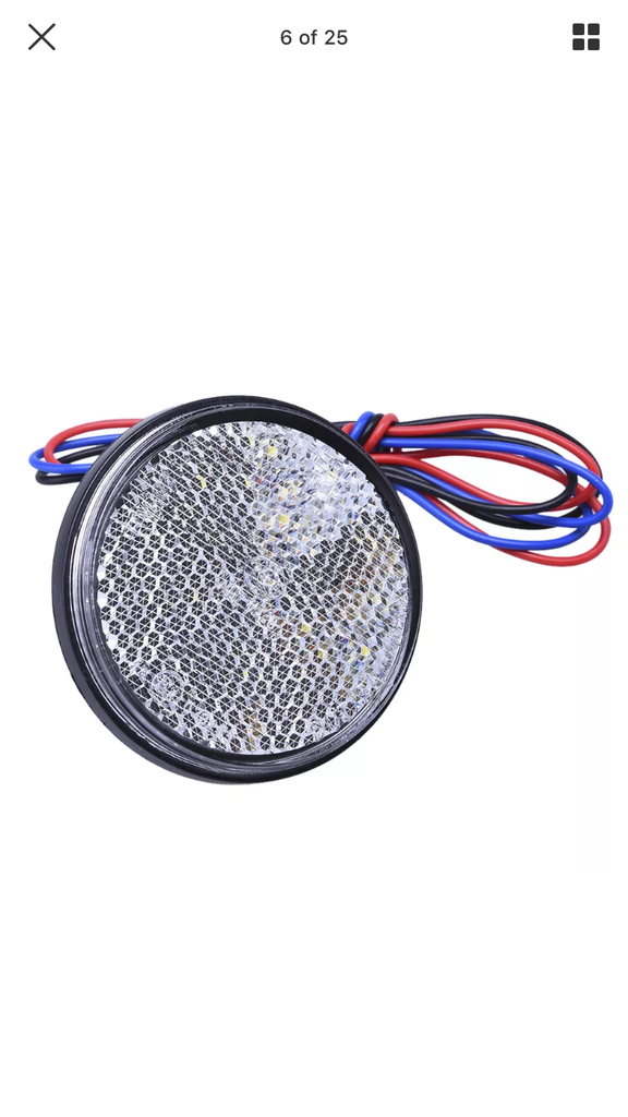

Well... After a searching for ages I found a reflector led that I like
Fog light
Reverse light
These are going to replace my current reflectors so that I can remove the fog and reverse light that sit behind the 2 rear grills.
Then I will be able to remove the grills dremel (finally!!) out the areas behind the grill to help release all the heat :)

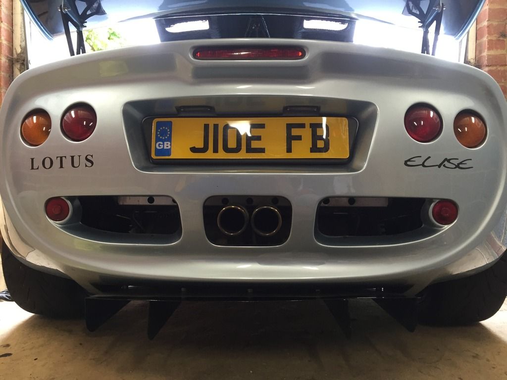

#931 gaffer1986
gaffer1986
  • 4,408 posts
  • Location:Colchester
Posted 28 July 2016 - 03:45 PM
Isn't there normally a grill for air where the holes are?
#932 The Batman
Posted 28 July 2016 - 04:31 PM
Yeah the grills are getting Powdercoated :)
#933 gaffer1986
gaffer1986
  • 4,408 posts
Posted 28 July 2016 - 04:35 PM
I don't get where your are planning to add holes, it looks like the holes where the grills were get covered up by those plastic things?

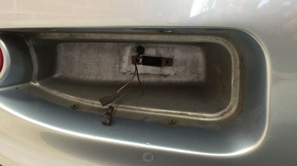

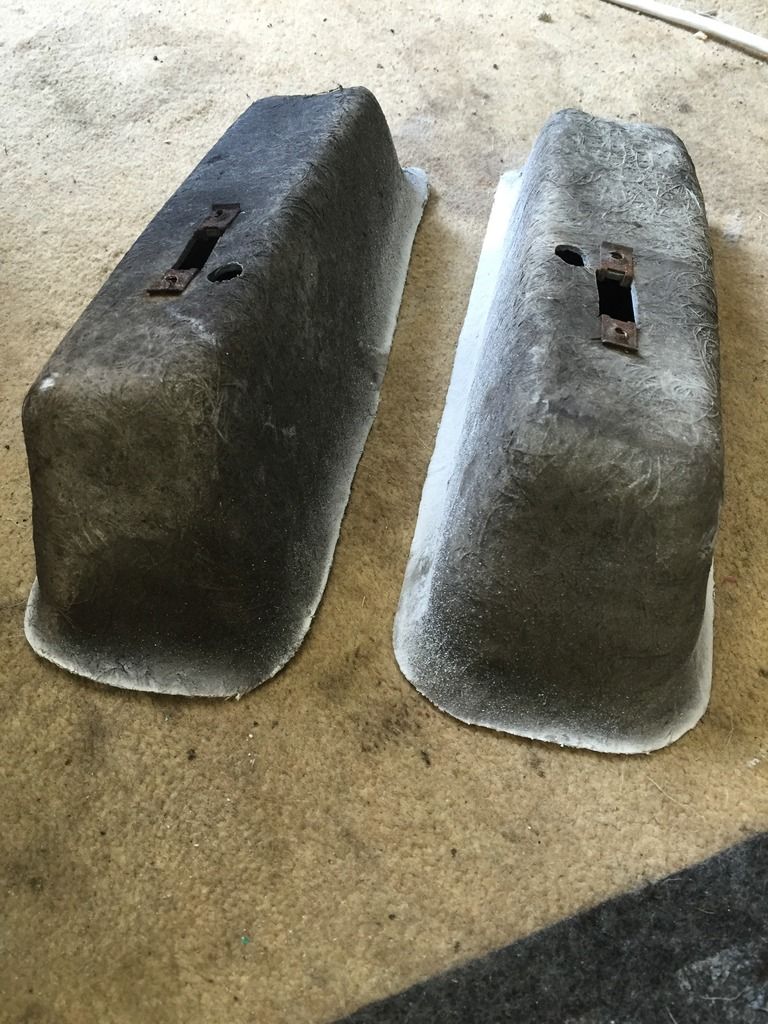

#935 The Batman
Posted 28 July 2016 - 08:00 PM
Lol you aren't the first to get confused maybe I didn't make myself clear :unsure: Oem = fibreglass behind the grill with either a reverse or fog light there. Then the grill goes in front of this What I've done is remove the lights and cut the fibreglass out. Therefore a big hole either side of the tailpipes. Then I will refit the grill
That makes perfect sense now. Still only going to be small holes, I hope it's enough although I'm doubtful it would make a huge difference. :/
#938 The Batman
Posted 28 July 2016 - 08:36 PM
Each hole is 300x110mm so I think they are big enough :)
#939 gaffer1986
gaffer1986
  • 4,408 posts
Posted 28 July 2016 - 08:39 PM
That's bigger that it looks in the photo. Hope it works.
