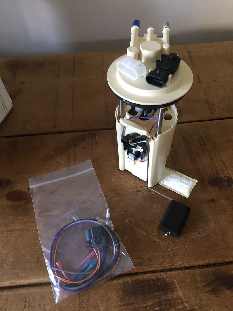

I suspect this is dead then! I have ordered a new one. It's done a few hundred since mapping so I suspect it's turned on otherwise I would have had a problem sooner?
Anyways I decided to get a spitfire pump and new canister
Let me know if anyone wants to buy one :D
