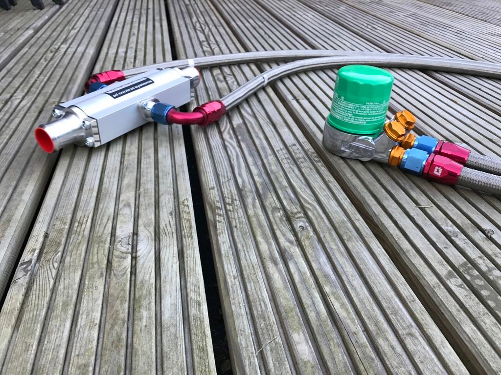

Posted 10 November 2016 - 04:04 PM
Decided to add some weight to the loti
A mocal laminova oil cooler, cpl racing oil filter adapter, small Honda oil filter. It's already tight so have to use a small filter to account for the sandwich plate

Posted 10 November 2016 - 11:36 PM
Your car already seems to run cold. Don't you want some heat for your heater?
#1216 The Batman
Posted 10 November 2016 - 11:43 PM
My heater runs really hot actually! Hence why it's left on cold! This is for cooling my oil down especially at the rev limit on track. My water pump is Beky driven so at 9k it's forcing a lot of water round the coolant system hence why it runs cool :)
