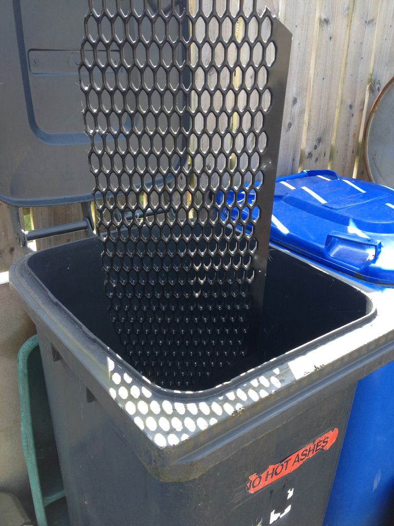

I've had a sheet of theRs4 style grill lying around since last year and as we're all growing old waiting on the Splam grill group buy to materialise I thought I'd replace my knackered chicken wire while the weather isn't great.
One thing I noticed is the gap between the crash box and clam isn't quite thick enough to accommodate the 10mm thick mesh at the top and the tow eye bracket will need turned around.

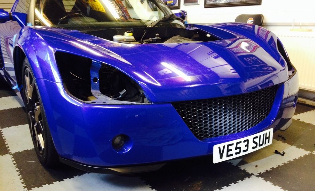

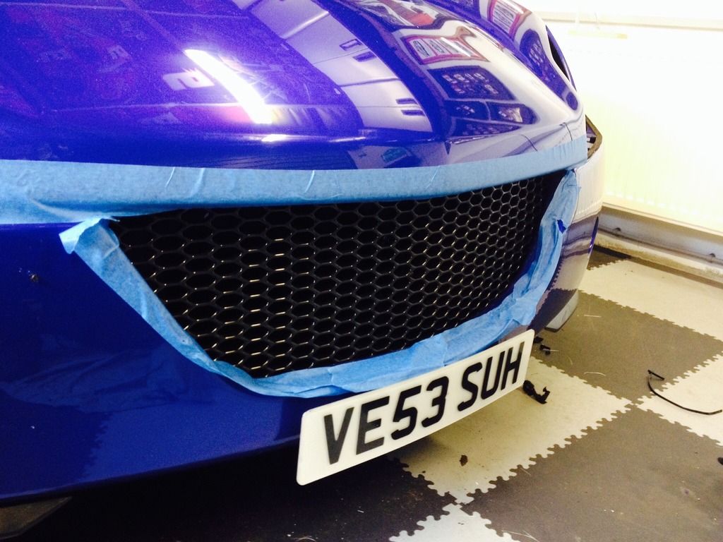

Anyway I made some little carbon fibre L shape pieces and bonded them around the inside of the front air dam to screw the mesh to and fitted it looks like this....
...I stood back and looked at it...
...and looked at it...
..and I can't put my finger on it, but I just didn't like it, in fact I hated it so fecked it in the bin.

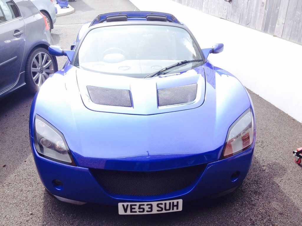

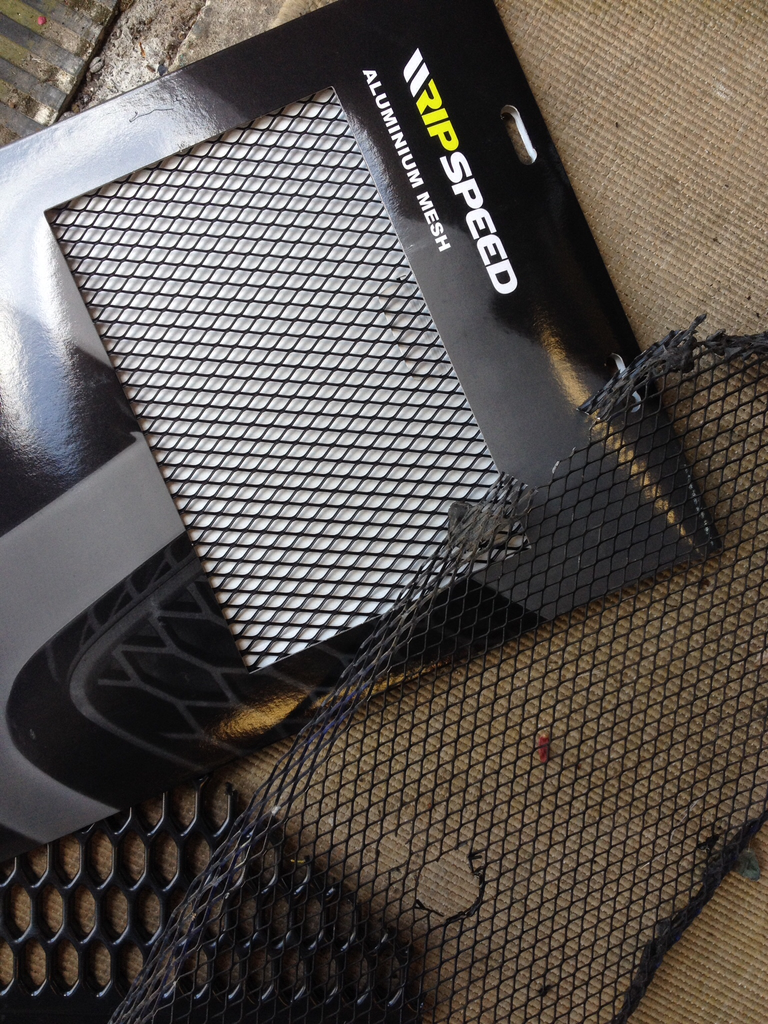

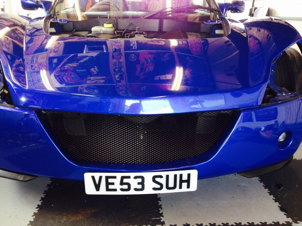

..went to Halfords and bought some
Fitted it and it's back to normal.
I havn't left a hole for the tow eye, so the grill is sacrificial if I need to tow the car any time soon. I'll cut a hole eventually when I get circular piece of alloy with some countersunk hex head bolts to tidy the edge of the hole if that exists.

The black anodized ripspeed mesh is identical to the original Posted Image Sent from my iPad using Tapatalk
