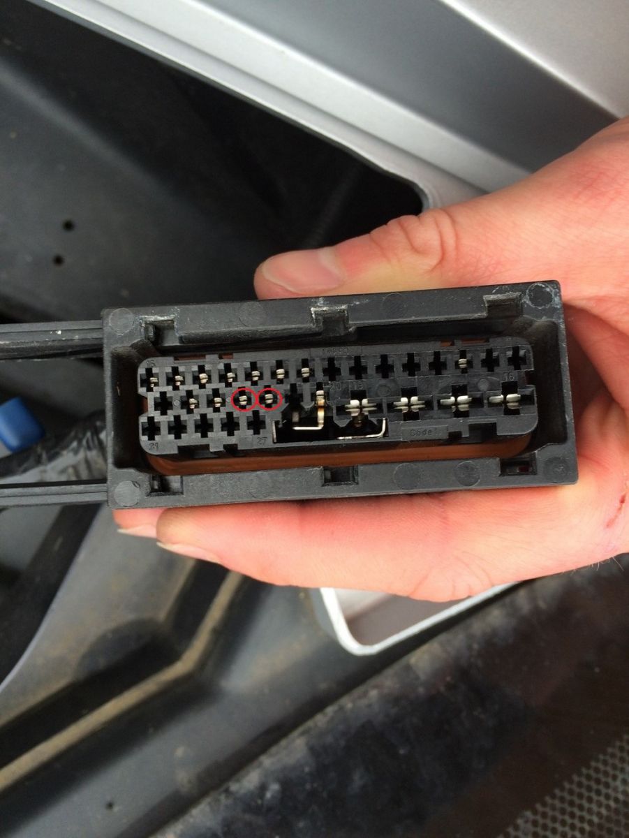

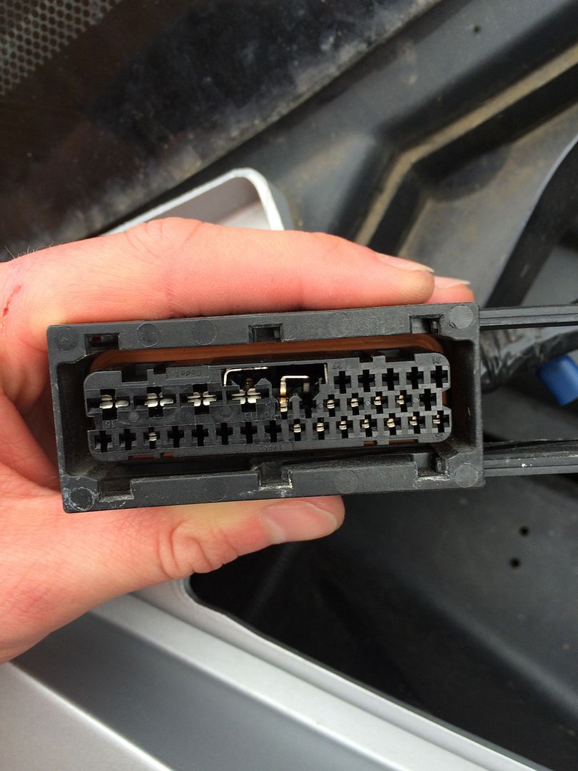

Just had a look at the ABS module, and noticed that there is some marks on the plug that look like scortching, wondering if this is normal or not.
Also, noticed after driving, that if i brake, ie shift the balance forward, then the speedo seems to work, then under load,leaning back, it sometimes kills the speedo.

According wiring scheme, the rear left (wheelspeed) sensor is connected to pin 22 & 23. So (let someone...) measure Ohm resistance with a multimeter accross these 2 pins:
Edited by Exmantaa, 28 June 2015 - 03:57 PM.
