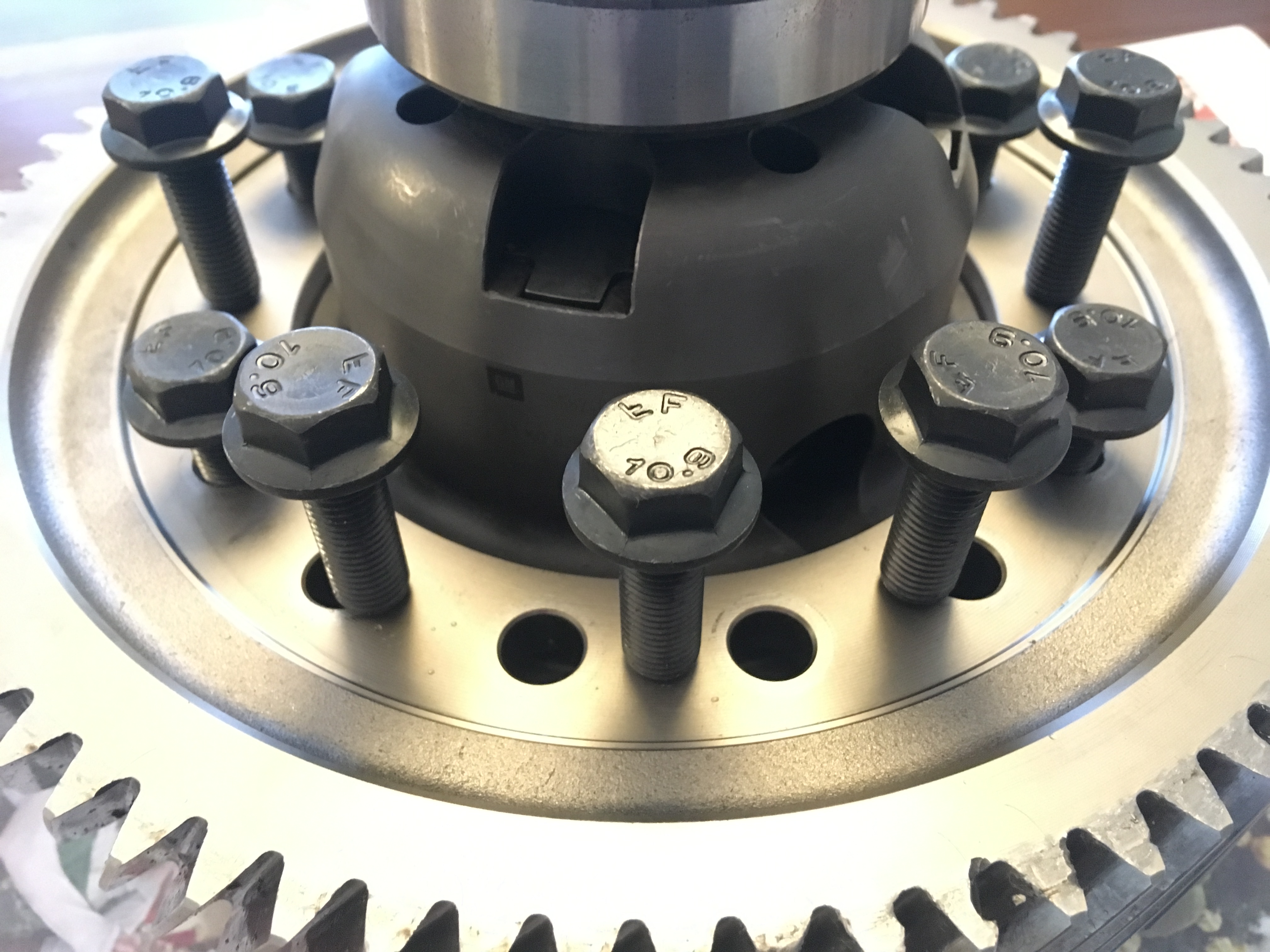

And in a stroke of luck, found a bloke selling a newly overhauled M32 with a jumpy 4th gear. Was dumping it cheap as no one was (understandably) keen on it.

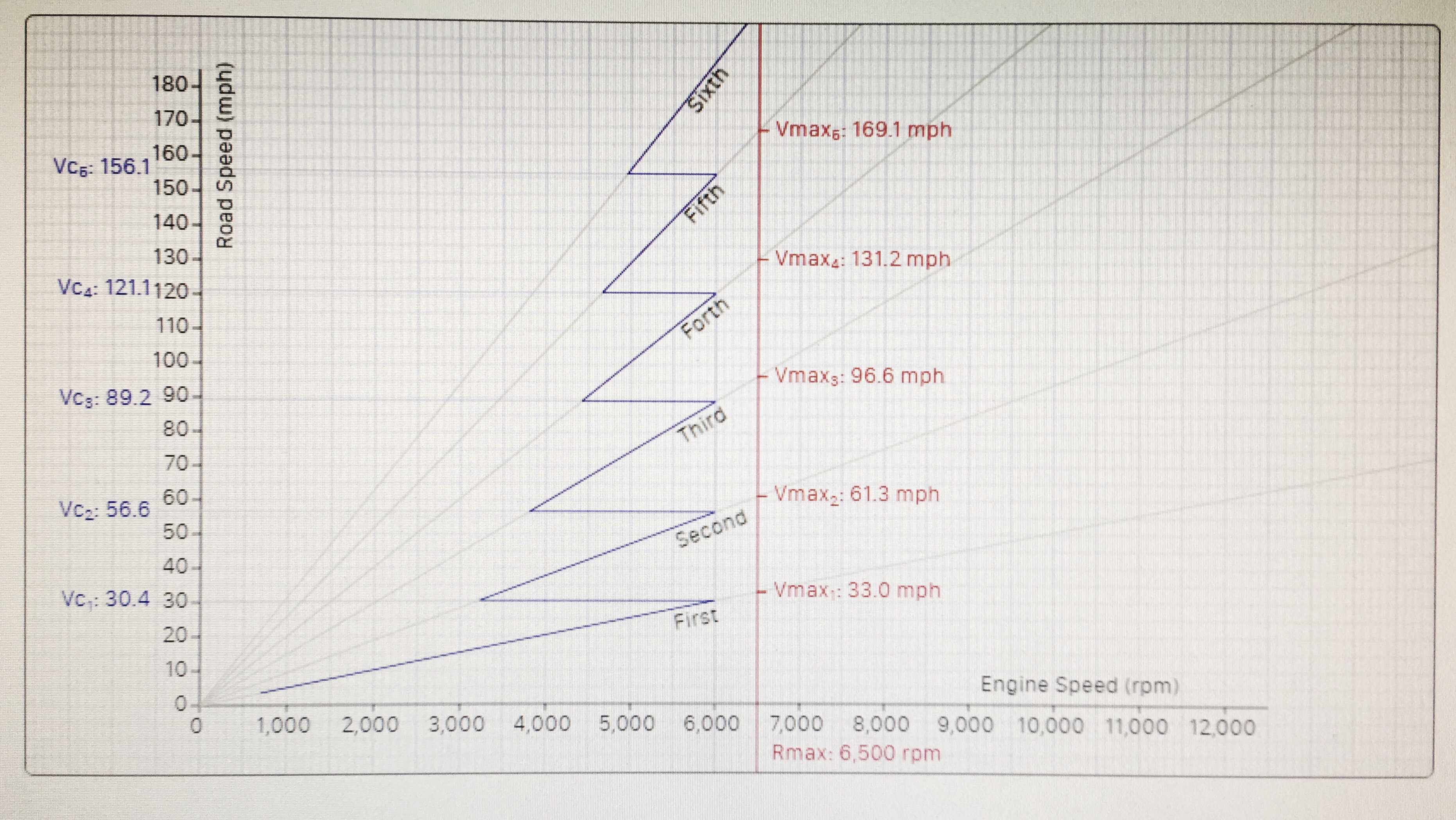

It’s a MZ4 6sp diesel box with a pretty close ratio and a tall 3.65 final drive. Rated to 400nm, it’ll be pushed if I can get mine making a reliable 500nm, but with only 800kg hopefully it won’t be an issue.
So yeah jumpy 4th post rebuild... perfect for me though! Being a diesel box, it needs a different front case for the 2.0L, plus Im considering beefing up the back case with the later version (bigger shaft carrier bearings and another oil gallery).

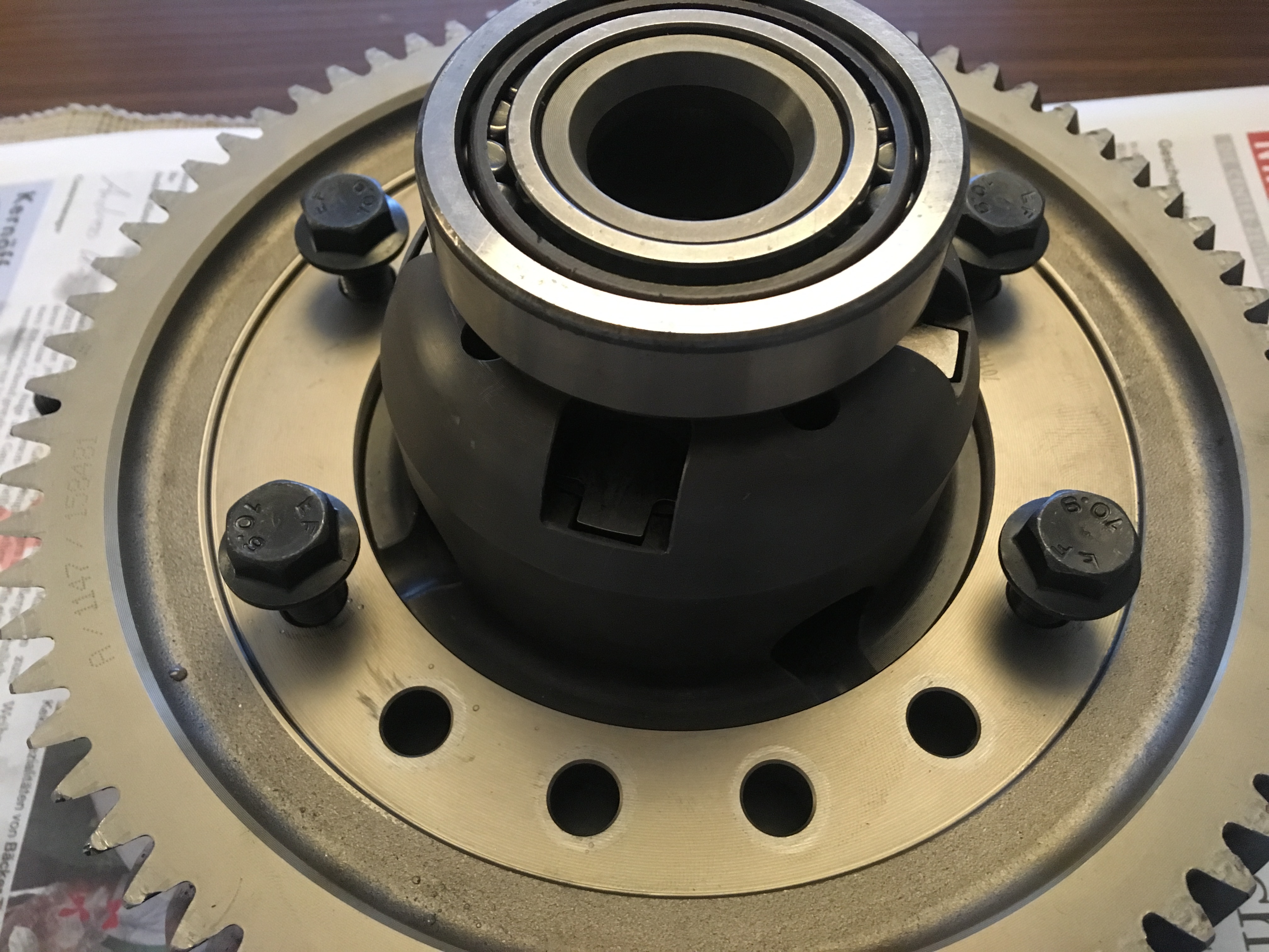

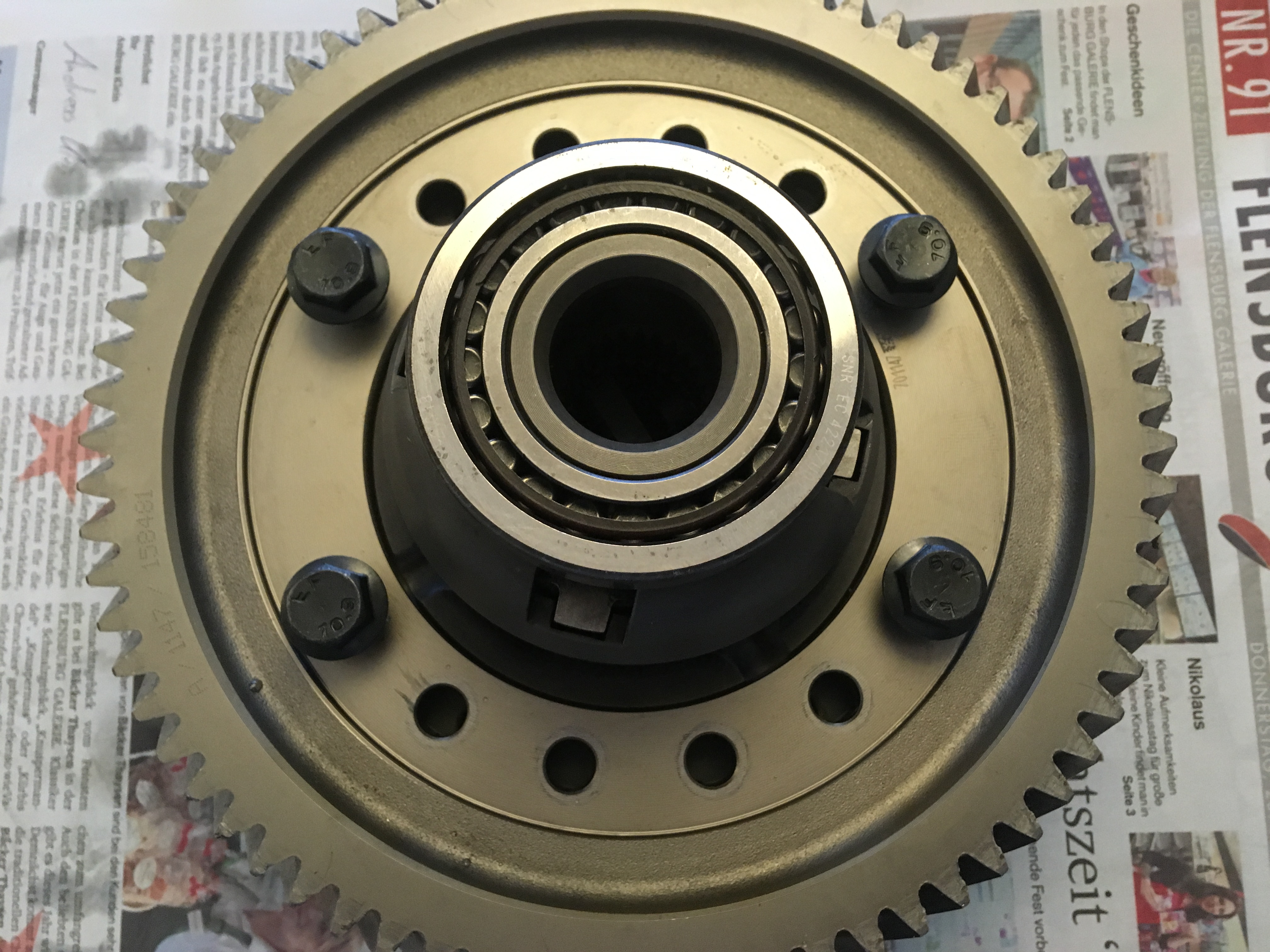

Not to forget the LSD that’s been sitting on my desk for the last 6 months. Contacted a bloke about getting the ring gear PCD milled today...
Absolutely pristine condition box post rebuild (20T pinions and 73T RG = 3.65 FDR)
Mix-n-match PCD needs to be machined to fit.

Drexler LSD
MZ4 3.65 ratio chart:
Original PCD comparison:
