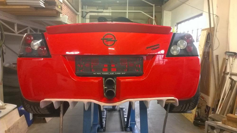

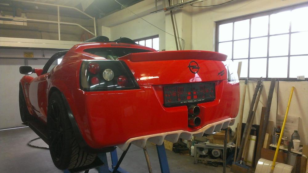

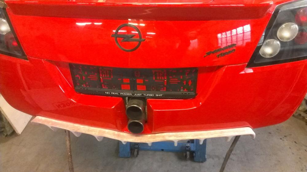

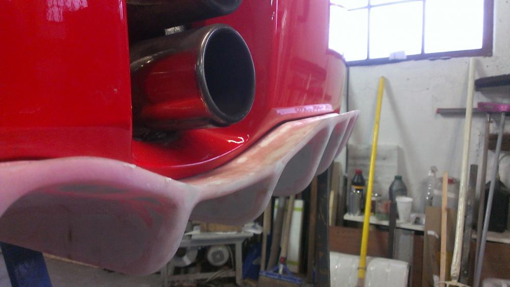

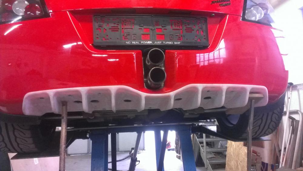

A German guy is working on this and I really like the idea with the moulded thinkness of the fins etc.:

that looks great, any more info? price/availability etc

All in beta. There is nothing. Those 4 small holes in the end of the diffuser will require you to drill your clam to fit. Other then that i love the hellaflush look.

That moulded diffuser looks very smart in those photos.

flush with the rear bumper and it would look even better.

Love the strapline on that guys number plate holder! :lol: That is exactly the sort of style of diffuser I have thought of trying to make in the past. Like the thicker more OEM look to it.

Personally I think it looks bloody awful.

Entirely agree,
I don't see why anyone would put energy into making the a diffuser look like a molded clio part

The pic was more to stir up thoughts for a different diffuser fabrication method.
(That German guy made a 3D scan of the underside, designed this in CAD and then had the foam part milled "minus a few mm" for the glass skinning. :sleep:)
Personally I do not like his design with the 10 fins, but I do appreciate the efforts to make something a bit more molded and shaped to our cars.  Instead of bolting on some bended sheets of alloy and calling that a diffuser...
