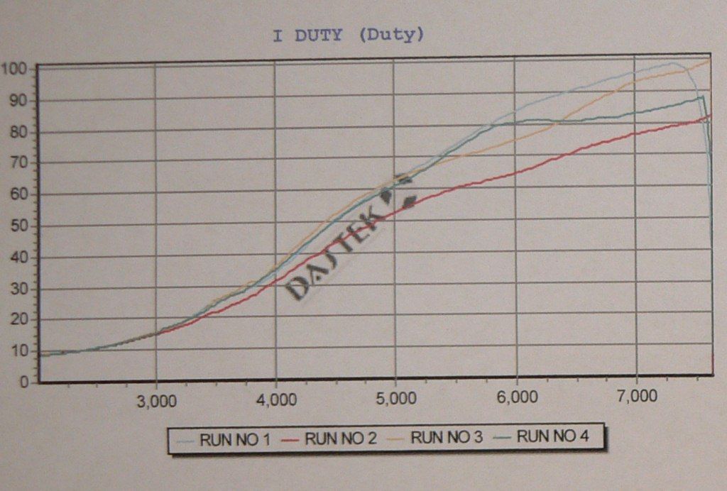

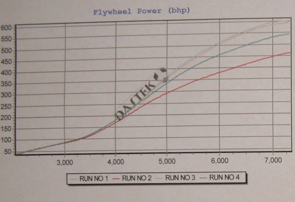

When I was on closed wastegate (the light blue lines on the graph below) and took the car to the rolling road at Castle Coombe the print outs showed it (optimisitcally) making 602 HP and pushing the injectors to almost 100% duty. :angry:
4 power runs (all at different boost levels):
4 duty cycles:
Edited by Nev, 17 April 2017 - 02:31 PM.

Was testing with different boost levels using a MBC.
With the wastegate locked shut the car was undrivable as it was almost wheelying (no exaduration) in 2nd gear as the torque was circa 550 ft/lb. Even in 3rd and 4th gear it would easily spin up the rear wheels with warmed up 225mm R888s.
