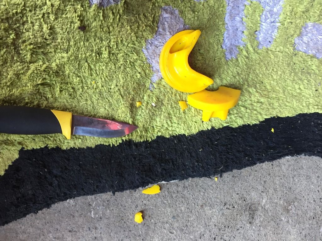

I couldn't find a how to for this so I've started one for others who are struggling.
First off get the car up on ramps. This makes access much easier, then remove the rear undertray. Once you've done this you need to remove the bolts shown...
Before doing this make sure you have supported the engine using a jack with a block of wood. Then make an attempt to remove the rear engine mount. At this stage you will realise there is one more bolt holding it on. This one is impossible to remove. Fact.
Now it is time to replace the 3 bolts you have so far removed, and in a fit of desperation/rage, take a knife to the inserts. Like so...
Now you can bodge them in like a proper ape. I suppose you could use some for of adhesive to keep them in but I found the following to be most effective...
Then remove the jack and whack the undertray back on. Bob's yer uncle, Fanny's yer Auntie. I hope this is useful to some of you and good luck

Last bolt I found OK to remove, but a right b'std to refit. Did my rear one a good few years ago thinking it was a simple job and regretted it for a couple of hours under the car trying to reseat the bolts. Worth it once done though, makes the gear engagement feel much tighter. Like the rage version too.
Edited by H1 HWK, 02 May 2017 - 07:26 PM.
#7 Duncan VXR
Duncan VXR
  • 5,283 posts
  • Location:Lincolnshire
Posted 02 May 2017 - 07:16 PM
Allow the engine to drop slightly and you will have a bit more play putting the bolts in and wood / jack under the mount will help to push back into place. Come with some copper slip usually and use this also 😏 Bolts will have thread lock on also and can make removing a bit more difficult DG

I get he left the mount in and fitted the insert with it all in place......I completely fail to see why the hell you would do that. Remove the mount and fit the thing properly. It's not difficult. Had it out 3 times in the last 4 weeks.

Normal sized hands, fail to see what's difficult but each to their own. Seems a shame to cut a brand new pu bush in half. For anyone thinking of fitting engine mount inserts this is not the way to do it!!!!!

Wind your neck back in HH, at the end of the day the part wasn't fitted correctly. Fair play for trying but this guide shouldn't be copied imo. Apologies if this reply offends anyone
