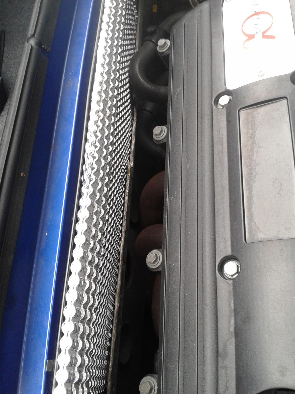

Shiny new tullet 4-1 manifold arrived today and will be going onto the new itb engine next week.... Should I be fitting the heat shield back on (will it fit), or at least heat wrapping the manifold - or just fit it as is? Don't want to heat damage the boot box, but then again it looks way to good to cover up!! Mat Sent from my iPhone using Tapatalk

You can best the oem one to fit however easier to just fit nimbus thumbsup

You definitely need something, I stuck some nimbus against the boot and wrapped the exhaust.
I may end up regretting wrapping the exhaust as the wrap soaks up water every time it rains which will likely make it corrode quicker.
You also get loads of people flashing you thinking you're about to burst into flames as it smokes (well steams I guess) like a mofo when heating up after it's got wet.

Added cost, but ceramic coating would do a proper job. Camcoat give a price guide here.

Easy to make one up using nimbus👍

^fcuked up there. Love this engine bay, and the Ecotec badge

I have a tullet manifold and have done the Nimbus on the boot wall treatment
Thread here: http://www.vx220.org...tion/?p=1823211

Nimbus and wrap all ordered... Sent from my iPhone using Tapatalk
