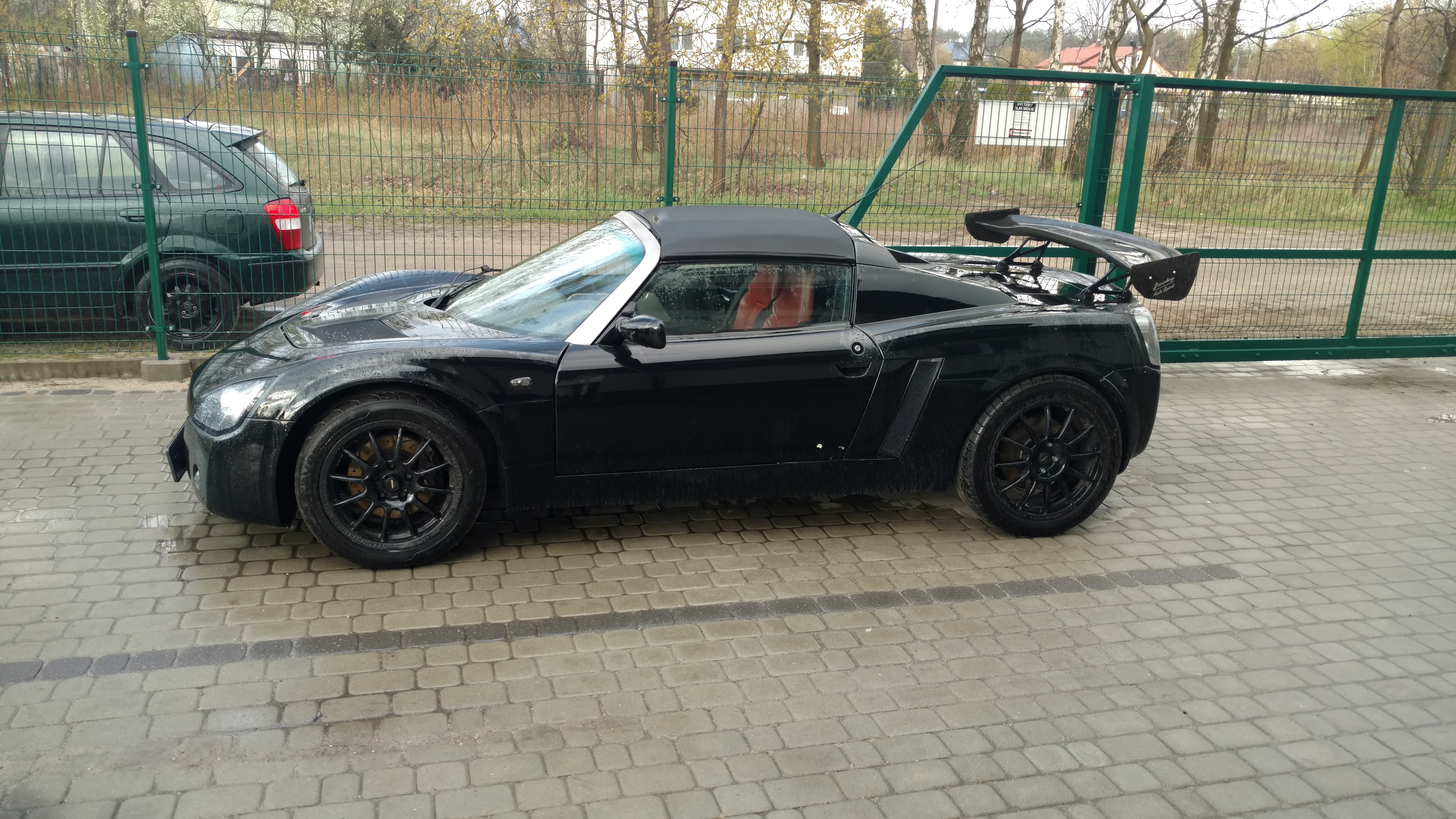

carbon rear wing will fix the case.
Lol I can see that making the front wheels completely leave the tarmac at high speed.....lol
#7 navx
navx
  • 369 posts
  • Location:Kent
Posted 16 June 2017 - 03:16 PM
You do need a BGW for it to have an effect. There is more lift at the rear than the front. It becomes a cat and mouse game though. I would say get someone to look at your geo Matt Bentley, Back on Track or Guillemi are usual go to places. Large rear wing will increase drag so unless you have plenty power or use car primarily for the track, I would not bother.

#9 piwo
piwo
  • 181 posts
Posted 16 June 2017 - 04:48 PM
Big rear wing doesn't change front grip to 120km/h where vx220 is understeer. After this velocity vx220 is getting oversteer. And rear wing help then. IT work only in big velocitys. Give Stable rear on braking to corner And traction on leaving the corner. Someone Who use IT on track know how much Stable give IT. Ok the car is slower on long straight (for example i have 180km/h not 185km/h on track i driving) but the car is Stable in 160km/h corners And times are shorter.
Those wings you linked to wont do anything except damage the clam. They're all body mounted and will crack the clam/ The profiles are mostly useless as well. Also you cant just stick a wing on the back on its own.
