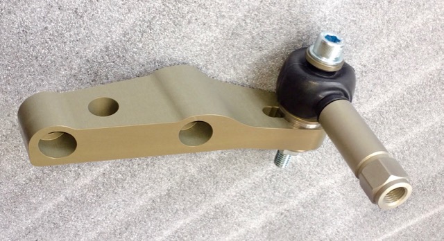

#7 Spitfire Engineering
  • 755 posts
Posted 18 October 2018 - 02:26 PM
A quick rack!
That is sooooo yesterday ....
This will do a much better job, give you lots of ratio options, has several other functions and will remove a few other things on your list at the same time :) ..... and save you a small fortune.
Ratio can be changes easily from -4% to +21% in 4% increments.
Full coarse and fine bump steer is now carried out on the arm in seconds.
Extra camber is built into the arm so no need to machine uprights.
The dubious OE TRE's are replaced with the same bearing we use on the toe links so considering the reduced forces they should give a service life or 10+ years.
#8 MAXR
MAXR
  • 2,719 posts
Posted 18 October 2018 - 02:30 PM
I do have a large pro alloy charge cooler rad upfront with twin Rad fans. No Tmap, no gearbox or oil gauges. Tank is long range pro alloy and is baffled. Changing the water radiator configuration, if that improves the cooling on long stints, then that seems worthwhile. I presume my elec water pump does increase water flow through the system anyway?
WI was going to be fitted some time ago, but I never got around to having it fitted.
Does the WI setup on Lee's car work well? Ive heard various positive and negative comments about WI installations.
#9 MAXR
MAXR
  • 2,719 posts
Posted 18 October 2018 - 02:31 PM
A quick rack!
I'll call you in the next few days for a chat.
#10 Spitfire Engineering
  • 755 posts
Posted 18 October 2018 - 02:33 PM
Cool
I may have another of your list in the pipeline .....
