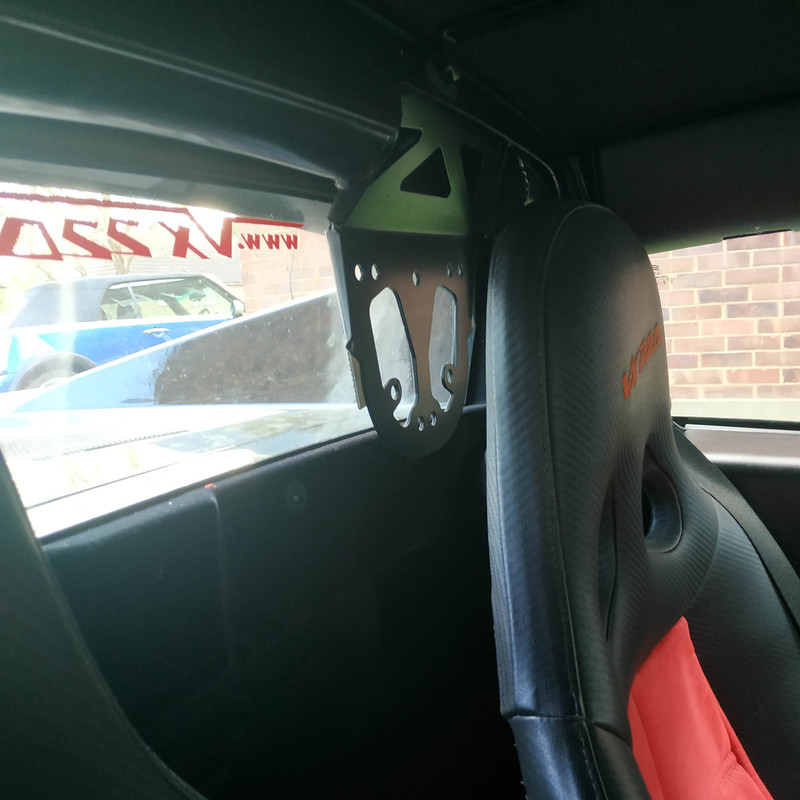

next on my list is to stop this headrest moving any ideas please i did try gluing it but it pulled the rubber off around it and now its looses again

A number of owners have removed theirs - a previous owner removed them on mine. It won't wobble then.

I removed both mine, the extra visibility is totally worth it
plus I can tilt the drivers seat back a bit and get more headroom (a problem with a helmet on)

The front section should be secured by 2 or 3 nuts to the roll bar bracket (so no way to move) and the rear hard plastic cover should be attached by velcro.

Sikaflex or tigerseal will hold it in place, but as above I got rid of mine

thanks guys i dont think my OCD will be able to cope with removing it  :blush:  :blush:  perhaps its time to find some sikaflex i think and try and bond it back in place
time to get the roof off and see what i can sort

There are a few people who have actually angle grinded off the ‘axe heads’ completely. This was a drastic step to far for me with unknown safety implications so I opted to go half way and did this neat solution -
The fronts are removed allowing the seat to recline slightly further and for you not to risk hitting your head on the plastic. I then filled and skimmed the GRP cut out and upholstered the whole roll bar cover along with axe heads. To finish it all off there are also 3 powerful interior LED spot lights dotted along the top.
