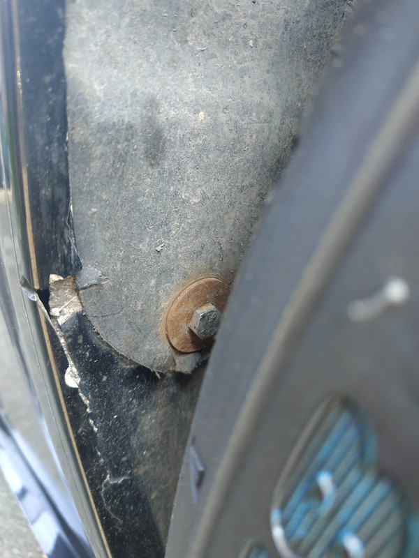

I noticed some rear arch damage when I got the car but am thinking about it more, now I have time to think.
I'm not going to get it repaired until I move (as soon as lockdown finishes) but what are people's thoughts?

Just fill it from behind with bodge that has fibre strands in for strength, then use the smoother filler on the outside surface.
Cheers. It looks a lot worse in the picture than it is, I just want to get something on it to hold it from behind. I'm thinking something like 'No More Nails'?!!
#4 Wolfstone
Posted 11 April 2020 - 03:39 PM
I think that's a stress crack rather than someone having dinked it.
It starts from the arch liner bolt, it looks as though someone tried to tighten it with a mallet and pushed the inner part of the clam back, the crack may have followed it.
I could be wrong though ..
Just thinking about this, does the clam to arch liner connection create stress on the fibreglass? If it pushes back on the clam then the stress has to have an outlet somewhere.

Mine had the same crack on both sides, seemed to be slowly getting worse before getting repaired too.

After it is fixed, you may want to consider adding a slab of carbon fiber to the section that get's peddeled with stones a lot.
I guess more material behind the source of the crack sorts it out then? Out of interest how much did it cost roughly?

It's a fairly easy fix to do yourself. I had a crack in the same area after the infamous asshole Dan Jude droped one of Haggi's, (r.i.p.), wheels against my car. It does'nt take too much to get damage in that area as there's no strength behind it.
Cheers, how do you deal with the face of the crack? Cut into it and fill it, rub back and paint?

Got exactly the same on mine. I drilled the crack to stop it spreading and wrapped it but you can drill a few small holes along the crack, grind a V channel along the crack and fill it with fibreglass filler.
