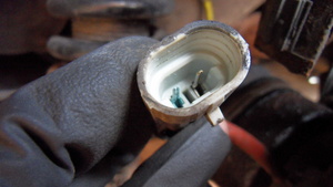

I’ve had the ABS light on since I bought my VX220.
I had a look and the blue wire just before the plug has broken. I installed a new connector, but ever since reconnecting this, I’m getting TPS failure EML multiple times until I just unplug it. Pedal doesn’t do anything, and idle is very lumpy.
I’m wondering if previous owner just clipped it and said it’s just a broken wire knowing it has another problem (he did this with a few other things as well). My Delphi diagnostics recognised RR as the faulty ABS sensor - plugging it in doesn’t remove the code (P1221), even after clearing it.
What is the deal with this? I’m not sure if this is connected (no pun intended) but the battery was dead after running for a few minutes and dashboard stuff spazzed out. I bought a new battery this morning (previous owner said ‘battery was new!’, receipt shows new in 2023 and it looks OLD, even installing a kill switch to stop the alarm draining OLD and KNACKERED battery - too cheap to buy a new one) and everything is fine, apart from disconnected RR sensor and impending TPS fault if I plug it back in.

#12 DavidB
DavidB
  • 15 posts
  • Location:Wirral
Posted 29 May 2025 - 11:06 AM
Thanks all for the info - I did do a check, all wheels are getting the correct signal but I'll plug this RR one in and check again. I got a =load= of connectors from a mk4 Astra and will replace the one that is playing up.
#13 DavidB
DavidB
  • 15 posts
  • Location:Wirral
Posted 29 May 2025 - 05:04 PM
I changed the wiring today with the plugs - still no signal from that ABS sensor. No wonder the gimboid snipped the wire, so the cheapskate wouldn't have to buy a new sensor.
Would it be worth buying a new hub? There is no continuity between the pins on the actual sensor.

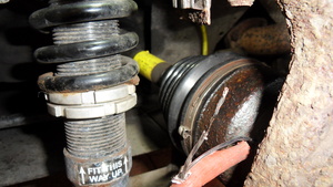

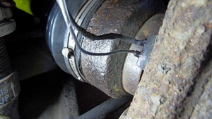

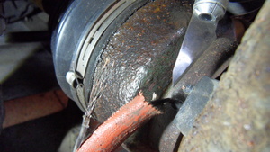

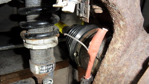

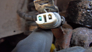

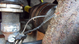

I had rear left go.
This is what I had , and did:
This was just a 'get to a quiter piece of life' fix and I put a new bearing/hub/sensor on the car, and never had trouble since.
#15 stevieturbo
stevieturbo
  • 127 posts
  • Location:cold and windy place
Posted 29 May 2025 - 09:09 PM
As a DIY test, extend the wires from another wheel to the RR position and see if there is a signal. That will at least verify the wiring to the ABS unit.
Or if you have a scope, scope the RR sensor and turn the wheel by hand, you should see a signal.
