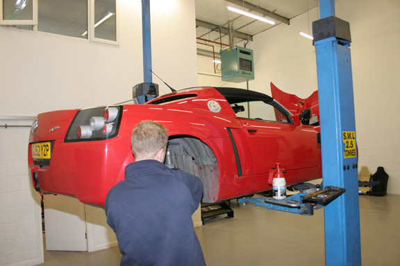

The guy who is helping me out has a 2 post 4 point lift (fairly standard similar to pic below). With the jacking points where they are there was no way we could get the arms to the rear jacking points and the front ones! We looked at every possible way and we couldnt get it to go??

Okay, just looking at that pic scares me, so all that is holding the VX up is that single jack??? Would not want to be under it thats for sure!
thumbsup
That is insane. :o

That is insane. :o
Agreed!! A four poster is what you need! or an inspection pit.

Hi Guys, The picture was just to demonstrate the type of hydrolic lift my friendly mechanic has. Not even my car, just a picture I borrowed off another thread! My problem is that no matter which way round we put the car we can't get the pads to the specific jacking points for a 4 point lift (i.e. 2 rear and 2 front)! For example if we tried to use the long arms to the rear jacking points there wasn't enough room between the main post and the car to rotate the smaller arms round to the front points. As far as I can tell we looked at all the alternative ways to do it an none of them seemed to work. Anyone with any experience using such a lift? Would really like to use it if I can as don't relish this job lying on my back! Thanks for any help.....
:D that's my car Marc.
We had same problem with the 4 pt lift, so resorted to a decent trolley jack lifting on the centre lateral beam.
I think you can use the jacking pts under the fuel tank cover (C on the diagram in the TIS schedule, next to the forward wishbone mount- accessed by removing the undertray) for a 4 pt lift. Seen quite a few VXs raised this way.

:D Thought I recognised the number plate from somewhere! Still does not look right having a car at that angle with only a jack for support.
