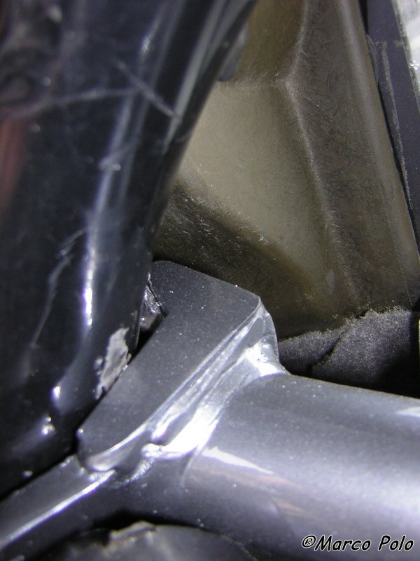

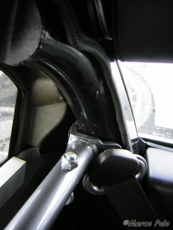

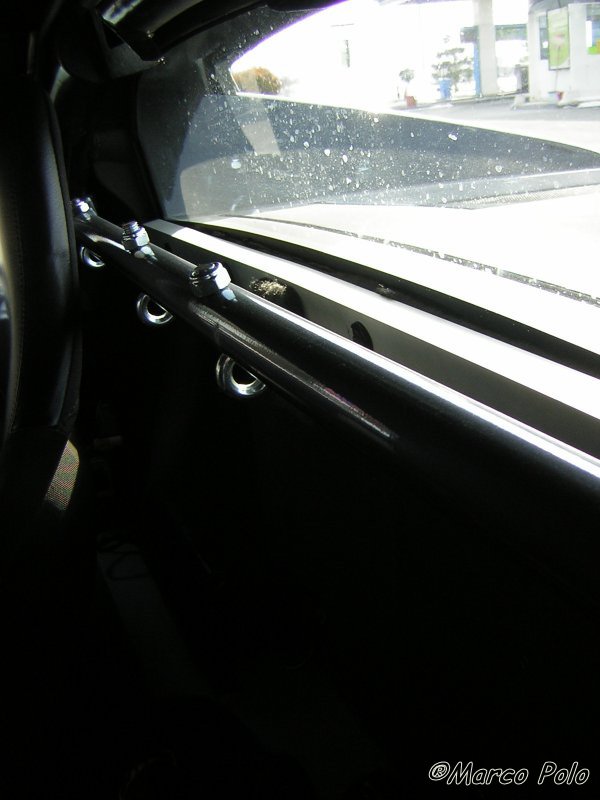

Last month I put a Moto-Concept bar in my VX...
I had a look at Elise's bar first (as we have many Elise in the 1-11 club), but none were a straight fit (there is no bolt thread in the VX's rollbar, Elise has them :beat: )...
Here it is :
Close up (here is left side) :
In fact the bar as been slightly modified at its ends (to avoid rotation) by welding a "L" shaped plate (here is right side) :
(Note: the bar was 3-4 mm too short !!!)
As for the harnest, it is not warp round the bar as you then must* cut out the seats and my body size doesn't made this possible (too tall). I just used "oeillets" (in french, doesn't know the word in english :rolleyes: ). The bar was a apin in the *ss to drill... :9mm:
When the work was finished (welding, drilling) the bar was painted to a nicer color than the original !
Many thanks to the body shop owner where everything was done... Imnotworthy
* a lot of discussions have been made on this, search for some other threads
Edit:
(Note 2 : my VX is modified : no more stuff behind the seats ;) )
