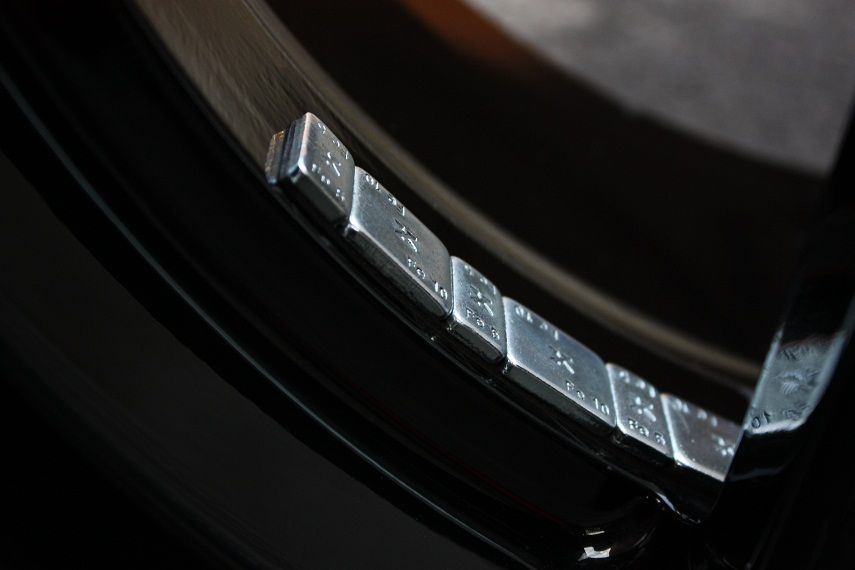

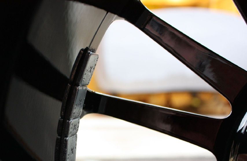

Just for you Simon:
Yoko's seem to need more weighting that other tyres, and 48s in particular, i've had a few sets now, and its always the same. The wheels haven't needed it on other tyres.
An 0Z on 48s
Speedline on AD08

Posted 07 May 2012 - 07:33 PM
Did you get them "precision" balanced, where they bolt them up using all five bolt holes and not the centre hole? I used to have stacks of weights on the TD's with 888's scattered around the wheel until my tyre place offered me the precision option. Instantly reduced the number of weights by at least 75% and better balanced at speed as well.

They aren't precision balanced, might look into that locally, i've never been offered it though, but they feel good. :)

Posted 07 May 2012 - 07:50 PM
I hadn't until they told me about. Same machine, they just use a different hub adaptor with holes at the right PCD to bolt the wheel on properly.The tyre place I go to only has one person that's been trained to do it and it takes a bit longer to set up initially (but usually quicker to do the actual balancing) and think it was meant to be £2 a wheel more expensive.

Posted 07 May 2012 - 09:04 PM
They may well call it something different but F1 Autocentres definitely call it "precision balancing". thumbsup

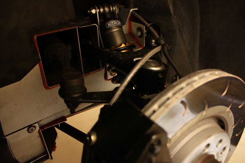

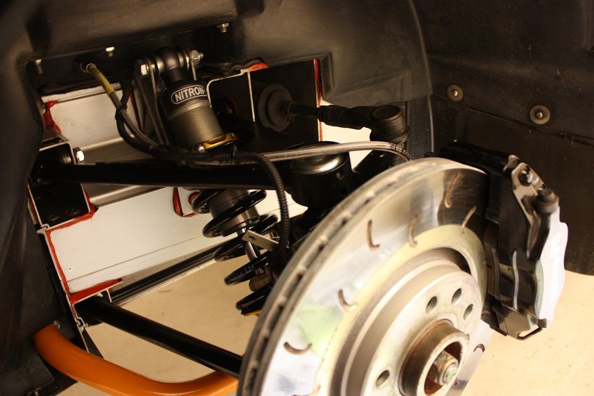

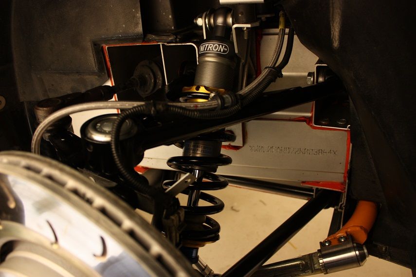

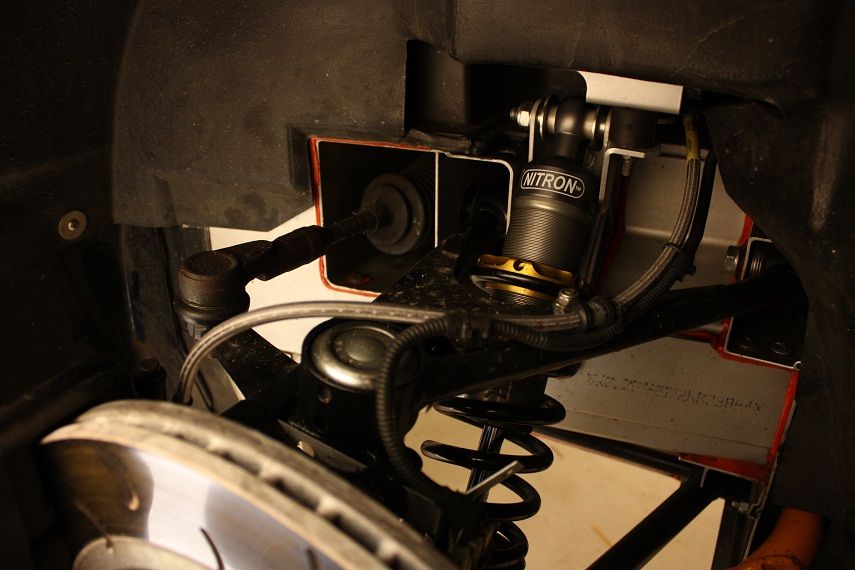

Posted 15 May 2012 - 11:19 AM
This is the cost of using the car in the rain - once (on the way back from Abingdon). It got all dirty (happened last year too on the way to le Mans :P)

Posted 15 May 2012 - 11:22 AM
Its ok though, i've fixed it :P
Front left
Front right
Rear right
Rear left

Posted 15 May 2012 - 11:23 AM
That's truly shocking. I really feel for you. :lol:

Posted 15 May 2012 - 11:24 AM
Those pics all look the same to me....
