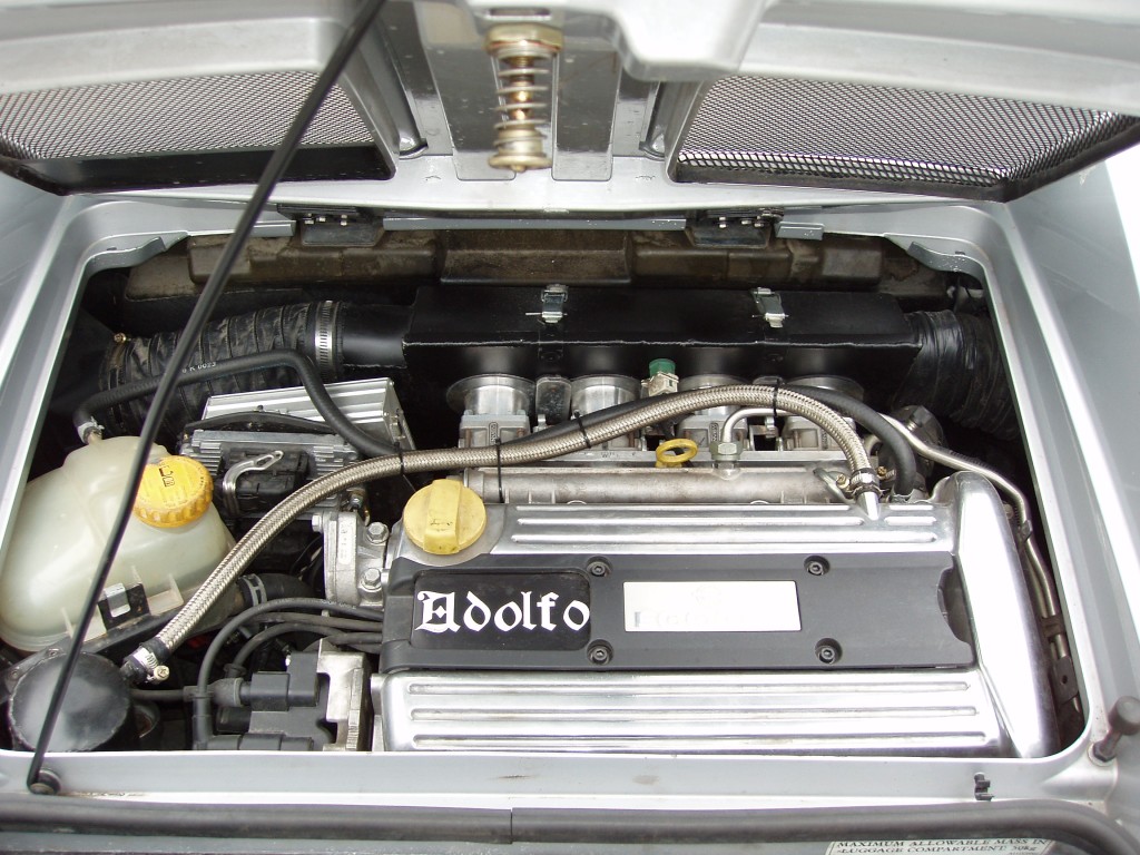

This one is running very well,now is developing 260HP from previous 243 with some improvment on air intake...

whats that behind the coolant bottle? with silver pipe leading to the engine?
#163 Arno
Arno
  • 1,238 posts
Posted 07 June 2006 - 01:11 PM
Looks like a catchtank for the crankcase breather at the top of the engine.
Bye, arno.

That's somewhat funny.... why did he squeeze the DIS ? :blink:
Wow! At how many rpm?

cicastol Do you have any more specific information about that car/engine? any links and such?
I want to know everything.
Hi Mattias,i'm still waiting more info from the owner, tuner used 2 complete crate engine+ 3 spare head alone only for development testing!! :o :o Major engine block and head mods are done for increased cooling efficencies\lubrication, emerald ECU,Eagle conrods,pistons,custom made camshaft,valvetrain,and much more......
Looks like he has junked the standard DIS and coils. You can see two coils mounted externally on the left side with plug leads running under the standard coil pack cover. One of my future mods, intend to connect some MSD coils to my MSD DIS-2. He has also maintained the standard ECU. The Emerald is mounted behind it.
Yep but why ?
Emerald ECU's cannot deal with the DIS ?
I do not understand where is the interest on replacing the DIS with a standard ignition system ?
