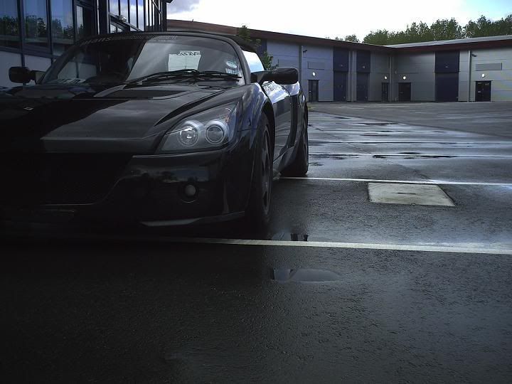

All done!
Measurements are:-
[from undertray]
100 mm Front
104 mm Rear
The dampers are very hard - no roll whatsover felt when taking corners at speed !

looks very 'slammed' as westwood would say. How does it handle or is it to wet to give it some.

The roads have dried out - and I did give it some ;) It feels very balanced - no over steer - no under steer encountered when taking some r/abouts and some country roads hard. Like I said before the dampers are so much harder/stiffer than stock giving a harsher ride. But this also makes it handle like its on rails! I have found that there is no roll on corners that I had very noticeable roll in before [reason why I wanted to upgrade]. I am very happy with the new setup but getting all of it done has been loads of hassle, taken loads of time, patience, cut hands, sore knees, and some swearing!!!!! :beat: :tt:

Sorry Chris, but i prefer it as it was before. :( looks to low now, upseting the lines of the car an generally looking a bit silly. In my opinon of course.

I quite like how low it is - very race car looking, not too practical though :P

As it was dry - I decided to test out the new setup after work.
To say I was disappointed was an understatement. The rear suspension seemed to settle alot and seemed low! So I took her out and found out I had copious amounts of understeer :o Something that im not accustomed too! ;)
So I made some adjustments and now have the ultimate setup!
Eventhough it doesnt look slammed - this is the best its felt :groupjump:
The Exige suspension is so so so much better than the VX - its very hard but when absolutely winging it around some of the usual corners there was no roll, and I can take them at about 10mph faster than before! Imnotworthy
Im glad to say the S2 Exige suspension has transformed the black beastie! :groupjump:

Running at 115/125 [approx]
