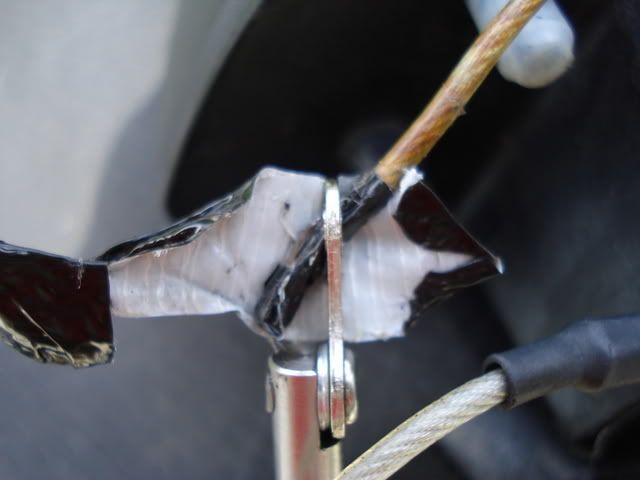

After snapping my cable last week, I purchased an ElizP987 cable from another forum member that no longer had a use for it (thanks, Matt thumbsup) and went about replacing it today. Easy job, took about 20 minutes. Worst problem was feeding new cable through :angry: but got there in the end.......
I knew my cable was rusty as I had noticed before and it eventually snapped last week. On inspection, the adjuster had bent as shown. I now realise that (as I panicked to put roof on in a torrential downpour) I had not lined the roof up properly and stressed the cable and snapped it :angry:

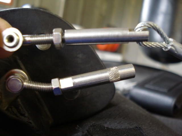

You can see the difference with the replacement cable - much more secure fixing
and my old, bent adjuster

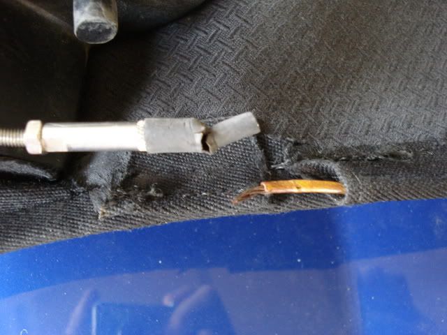

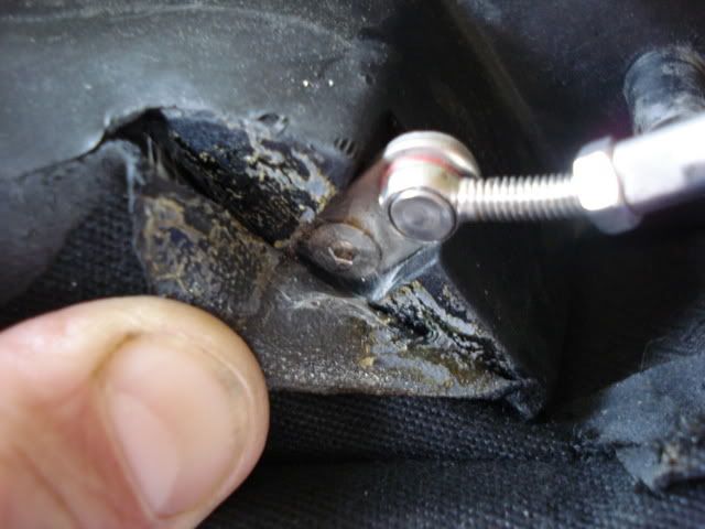

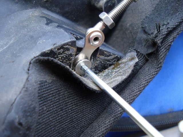

The cable is secured by a bolt hidden underneath a piece of fabric that is glued in place. Peel this back to expose the bolt. A small allen key is required (think prob 2mm) to undo bolt

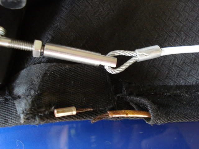

Now the fun bit. By taping the old cable to the new it can be pulled through. The fabric is pretty tight and the combined thickness of both cables makes it hard to pull through without the two cables coming apart. I found the best way was to hook the old cable through the bolt-hole on the new cable (so it isnt quite so thick) and taping with strong duct tape. I wet the end which helped it run through easier
Once through, secure both the ends.
Re-glue the fabric that was peeled back and adjust cable as required when fitting. I found it easier to unbolt the adjuster end of cable to adjust it, as the when tightning or loosening, the entire cable turns and by ubolting it it turns easier, if you see what I mean....

Good guide! The one slight downside of the replacement cable compared to the Vauxhall one is that you can't adjust the length without removing the bolt hidden under that piece of fabric (unless I've missed something) - with the standard cable, the cable is free to rotate in the adjuster, making it a very quick and easy job to change the overall length and hence cable tightness. Having said that, that minor downside is far outweighed by the major upside of the better quality cable - I've replaced one of my cables with the Vauxhall part, and one with the ElizP987 part, and the ElizP987 part was both easier to feed through and obviously better quality.

I deviated from the guide a little bit by attaching the new cable to the intact end of the original one, using a bit of wire coathanger through the bolt holes. This means there's virtually no chance of the cables coming apart half way through. HTH thumbsup
