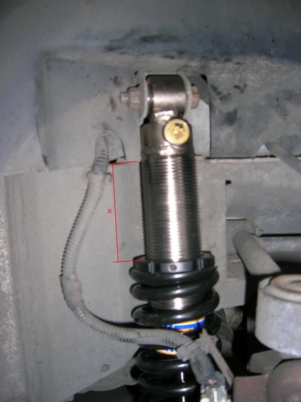

#32 siztenboots
Posted 30 March 2008 - 08:22 AM
:yeahthat: Please don't use the bodywork , especially the clam to take measurements from. The measurements from side to side can be out by a large margin, the bodywork is thrown on at the factory and will be shimmed out to remove manufacturing defects to achieve a reasonable panel gap. Instead please use the ends of the chassis members, not the undertray. Also take a measurement from the platform adjuster to the last thread on the shock as a reference point for future to compare to. Keep notes as you go,
Edited by siztenboots, 30 March 2008 - 08:23 AM.

#34 pincher
pincher
  • 1,167 posts
  • Location:Essex Riviera
Posted 30 March 2008 - 02:58 PM
Well, I see the words but they aren't making sense to me! :groupjump:
Chassis members? Platform adjuster? Sorry, no idea what you mean!
#35 mandarinvx
Posted 30 March 2008 - 03:04 PM
This is the platform to top of thread measurement:
NB - you'll also have to measure the length of the spring thumbsup
Edited by mandarinvx, 30 March 2008 - 03:05 PM.
