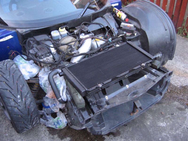

Rads in :)
No major problems, thank god!! The 3 screws windscreen side of the rad near the master cylinder etc were dead easy to get out, the only 3 which needed cutting were the 3 number plate side of the rad which are easy to get too.
One thing i have to see is one BIG THANK YOU to Liam (l14mha) he called in to help on his way back to chester to give me a lift, well i say give me a lift, he did everything!! i did bugger all!! i was the helping hand!! hes done 2 before so new the script!
He left about 7pm after he bled the system and checked everything was ok...in all i reckon it took him 2hrs!
So thank yo Liam i owe you big time for this... the beers are on me chinky chinky
All i have left to do is sort out the wiring on the new horn then start to put everything back together!!
Also were can i get Rawl Nuts from.. B&Q / Wickes dont do them anymore!! :beat:

Rads in :)
Cheers
Nick
nick,
was good to meet you and to be of some help...
glad we got it in and bled the water system through.
good luck getting the clam back on, i would have stayed and finished the job off, but i had pre-arranged plans with some old uni mates.
i'll give you a bell when i'm next up in manc.
liam chinky chinky
No probs mate!
To be of some help!!! You did everything for the rad change!!
I feel like s@#t today.... working all hours / temperatures has fubared me :( ... last night i was freezing with a mega temp, couldnt get warm at all.. am in work today as i cant be arsed going home to bed, because i know i will make myself worse by working on the car! LOL!!
Basically all the rad and rad housing is back on, all stainless fixings are on and copper greased.. the little screw by the the brake servo took me about an hour to get in!! :beat:
Sorted the horn... much better than the standard jobby B)
One thing i couldnt help but notice and commented to Liam, my o.e rad didnt sit on the foam?? (see guy182 pic)
And i have to say this is prob why i struggled getting the little 5mm bolts in as i need to push down on the rad shroud to get it going...
I have the pro alloy rad @ £299... has anyone else with an N/A fitted the same?? as i feel the rad housing is sitting a little high on the crash box.. (see guy182 pic) in the pic below the rad housing sits perfectly on the crash box, on mine now its a couple of mm off the crash box... my concern is the bonnet will sit high?? Ive had a look underneath and the rad is sat perfectly and there is nothing in the way letting it sit lower...
Any ideas folks?
