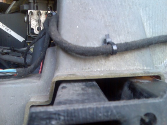

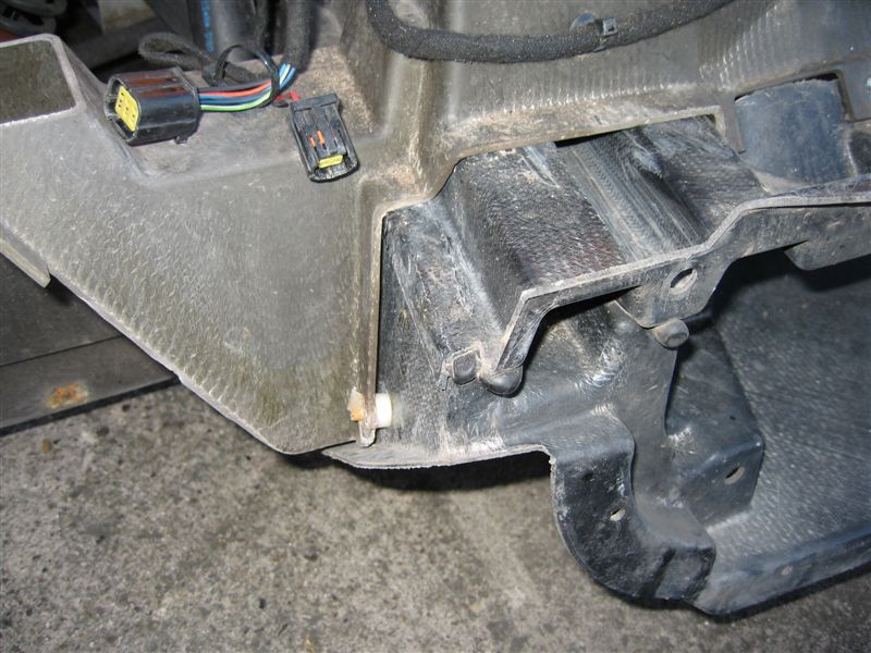

anyone??
Just realised i posted the same pic twice! LOL!!
Heres the other one...
Cheers
Nick
Edited by njc11, 26 February 2008 - 09:57 AM.
Cheers
Nick
doesn't look that bad

vocky thats mine.. njc says his sits a few mm up.

Yep that was guys pic... Im still not 100% :( this bug has really taken it out of me! :gayfight:
I might go into the garage later and take a pic..
I just dont want to put everything back together, clam on etc, to find it has to come of again...
When doing the 3 screws up at the front of the car on the rad housing, had to put pressure on the panel to get the screws in, then the ones which sit accross the back (master cyl side etc) again you have to put your weight on it to get things to line up.. If i ever went for a supercharger conversion (watch this space ;) ) i dont see how i could fit the pro alloy pre rad in??

Right here u go, the pic showing a bigger gap!!
Do you think this will effect how the bonnet sits.. i think it will sit proud of the clam ???
If it does... how do i adjust?
Cheers
Nick

did you leave the foam on ? mine hasn't the foam, sits flush, seeing as how the rad bolts to the rad housing i don't see it as a problem - so maybe remove that ?
#29 njc11
njc11
  • 1,057 posts
Posted 03 March 2008 - 10:52 AM
Mine hasnt got the foam! So basically sits on the crash box, then the rad housing on the top.. Cheers Nick chinky chinky

how did you sort this??
i sold my turbo rad to a forum member and he has an NA, hes just tried fitting it and says its thicker than his NA one and is a bit concerned on the fit?
Guy,
Just ended up bolting it all back together and it fitted a treat.. thumbsup
I just thought with the extra height it may throw everything out of align.. but thinking about it when you put the clam on it, it will sit on there correctly as there are some fixings from that crash box which go through the clam aswell just near bonnet hinges.. thumbsup So all that worry was for nothing..
Hope that helps! thumbsup
