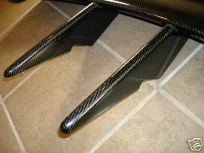

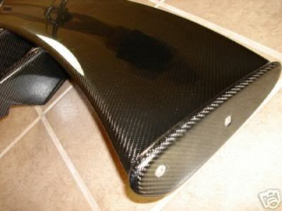

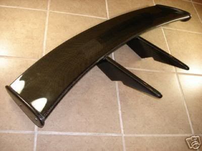

I was looking at the carbon one on ebay:
It'd be a shame to hack up those mounts tho :rolleyes:

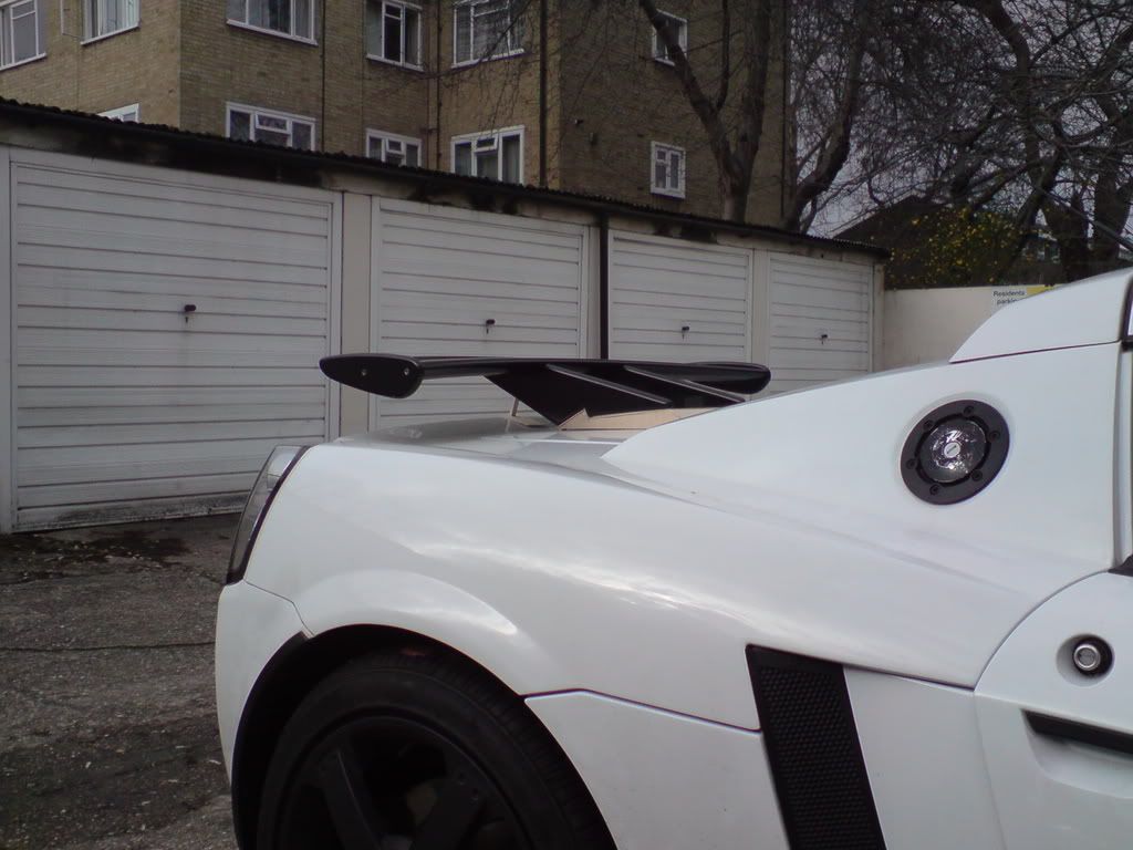

Looking good and nicely proportioned, you're onto to something - will you paint it white or keep it naked carbon? One thing I remembered, when we were testing an Exige at Spa last year we found the car would go faster without the wing, it was creating too much drag, try keeping it low and the aerofoil blade dead level, might be worth talking to Reverie because they've played around with that wing for info. Cheers Ian

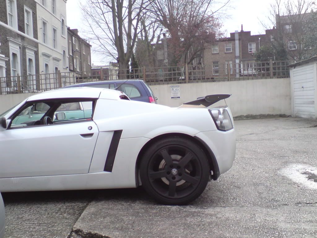

Looks goodthumbsup, can you post a pic standing aside half way down the door looking towards the centre of the rear?
I'll have a go in the morning

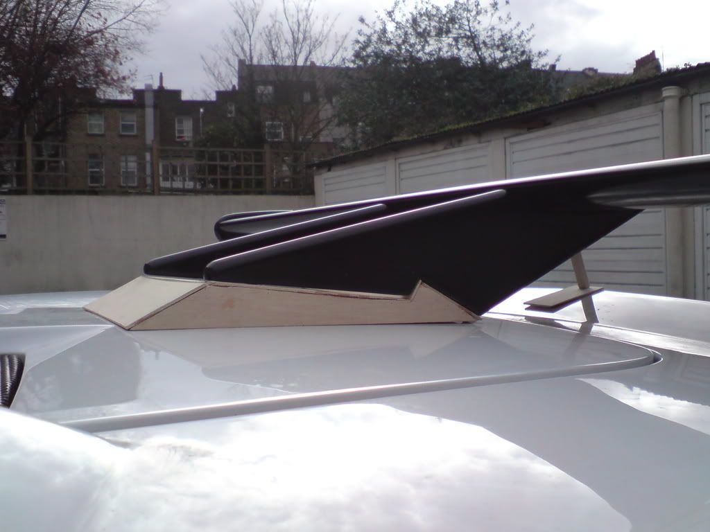

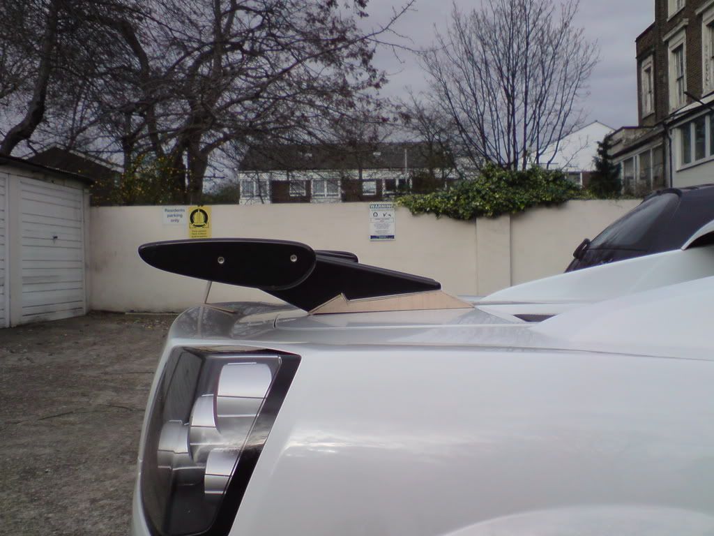

Got some balsa from local model shop and had a go making some thing
for the wing to fix to
Any one got any idea's about how I could get this made up in ally
I'd like to really just send some one the model and they could copy it
in ally and send it back ?

The Baron, What about a carbon plinth to support the wing, silly request any chance of a photo shot from above to give an idea of the width of the wing in relation to the sides of the rear clam , I reckon you'll clear turbulent air from the sides and not pick up too much drag from the roofline. Cheers Ian

i like it Imnotworthy have u had a go at angling it up a little at the back rather than just flat chinky chinky

Looks bloody great mate Imnotworthy
I think you may need to mount it at a bit more of an angle to get the full benefit tho, the blade position (going by the screw fixing positions) looks straight in your photos
Here's an Exige
Which seems to have an angle of about 10 degrees :blink:

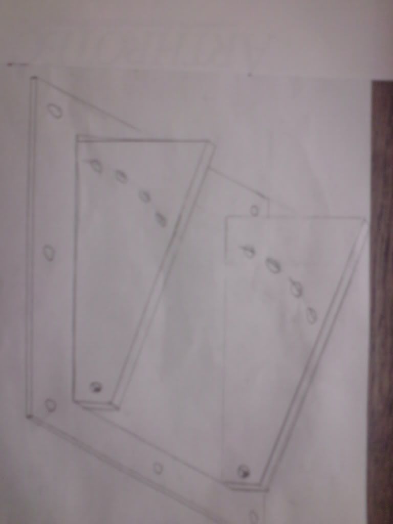

Right my mate Danger 7
reckons mounting the blade at a level position is a good place to start
I had the wing bubbled on the car dead level from front edge to back edge
on closer inspection of the s2 wing your see it is concave
I plan to mount the wing on something like I made today
but will attach it to the boot lid with an adjustable plate of some kind
have this sort of thing in mind
sorry about image taken with sh*t fone
I plan to cut 2 slots in the boot lid
then fix this from below
firstly removing some of the top and lower skin of fiber glass
and then re fiber glassing after the bracket has been secured
then sanding down etc and painting
to leave to fins protruding that the wing will be mounted to
I hope this makes sense
I may well make the Holder as shown in Balsa from carbon fiber
maybe the guy making the door cards could help
but this may well cost loads
so I think I'll start in ally
