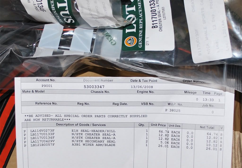

#11 mandarinvx
Posted 13 June 2008 - 04:43 PM
Right then, here are the part numbers and prices (VAT to be added!)
#12 mandarinvx
Posted 13 June 2008 - 04:44 PM
* Obviously you don't need to order the wiper arm & blade :rolleyes: :)

Mandarin: Thanks - this looks very good. Makes way more sense for me to get these than mess with my tired old NA seal.
Couple of questions:
I understand the ones on the tops of the doors need gluing on but what about the main seal - does that have self adhesive tape on?
Why are there 5 parts? I am abroad at the mo but IIRC the car just has one main seal plus what's on the doors.
The 5 parts are the main door seal (1-off), the windoe chasers (2-off), and the stips that run from the chasers down the door (2-off)
The chasers need to be glued in place at the top of the mirror base, but the strip type parts all come with adhesive strips
If you look at njc's pic, you can just make out that there are two seperate parts in the picture
