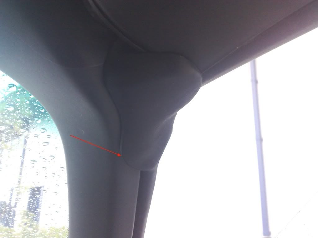

BOLLOCKS!! :angry2:
Didn’t work! just had a heavy down pour, had a look in the car and there was a great big puddle on the sill!
it seems to be coming in behind the flap below, any ideas how/why and how to fix? do I just plaster the whole thing in silicone? seems a waste of £140 if that’s the case as I could have done that with the old seals!

I still haven't fitted the other parts - just the main top seal, and still keeping dry thumbsup Aron - I did put a little 'ball' of black sticky gunk where the cup starts at the top of the screen - if you look from the top with the roof off you can see that where the cup part starts there is a place where the water could pool and go under the seal rather than over it :huh:

Plus are your windows adjusted OK?

Yeah windows are adjusted fine, will have a go with some silicone soon, but its somehow still getting into the driver mirror housing too!
