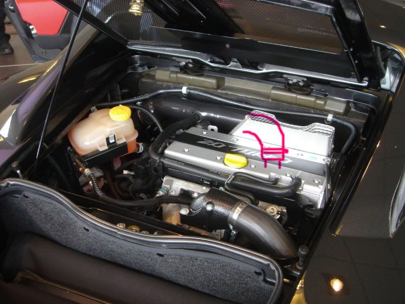

I looked yesterday fettled all around the pipe and gave up poof
anyone care to guide me round this pic or photoshop a nice big arrow on it for us non-mechanical types!
#23 daggles
daggles
  • 300 posts
  • Location:St. Neots, Cambs.
Posted 15 September 2008 - 06:15 PM
I'm glad someone else asked where it is first :P
Sorry about the shaky hand.. it's behind the heat shield. It can be quite a pig to get off the first time. If yours wont shift, undo the other end at the AMM, that gives you lots more wriggle potential. You'd think having taken it of before, next time will be easier but it's not. I gave mine a very light smear of vaseline before I put it back.
