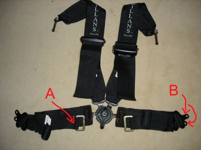

OK - here is the harness. The top (3") belts I understand.
The lap (2") belts confuse me in 2 ways:
A:
What is this short second belt sewn on top of the main one with a square of metal at the end?
B: How come each lap belt ends with two attachment points? Each point is about the same size as the ones you push into the main release.
#7 mandarinvx
Posted 09 October 2008 - 07:49 PM
Aren't the 2" belts just there so you can tighten them :) No idea why they've used two connection points :unsure:

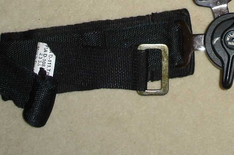

The bits with the 'handles' on are about 1.5". The pic doesn't show it well so here is an enlargement:
The extra bit goes from the white label to the 'handle' and is sewn on for half it's length. It wouldn't help tighten anything!
No me. Now I look loser, I cannot even see how you would adjust lap belt length if both mounting points were attached to the car ... :wacko:

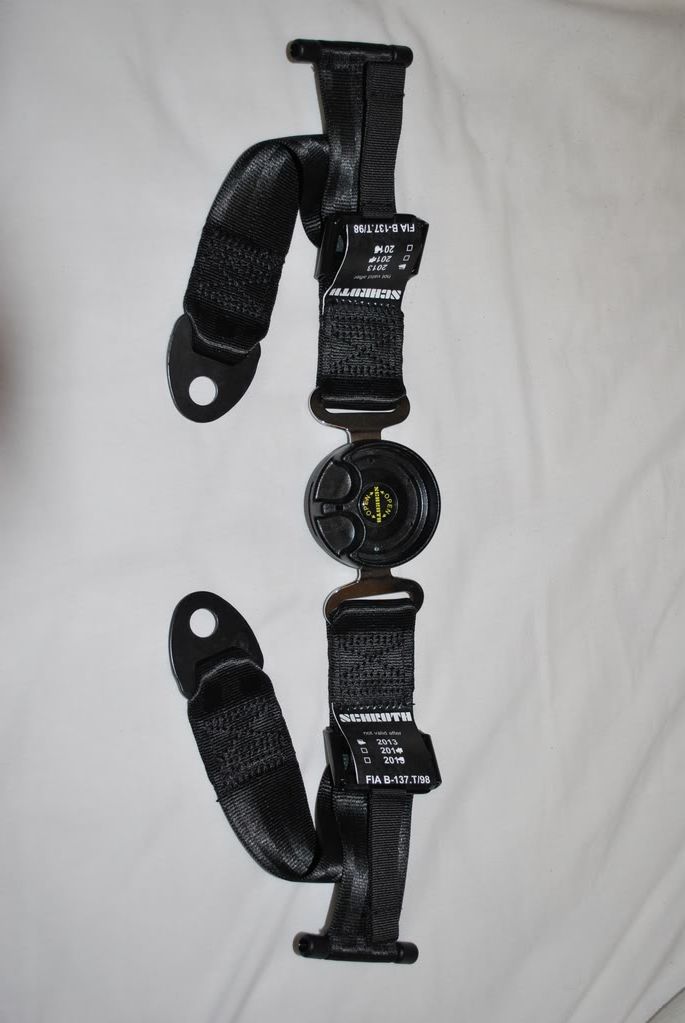

Posted 09 October 2008 - 07:59 PM
This is what my Schroth harnesses look like:
#10 Retset
Retset
  • 1,766 posts
  • Location:Somerset
Posted 09 October 2008 - 08:54 PM
No - it's different. After an age on Willans website I have determined that the 'handles' are actually D rings for crutch straps which pass through and then the shoulder straps go through them. My set are obviously the same but with the crutch straps binned. Here's a close up of the crutch arrangement:
My set would appear to be, therefore, something like this
That said, I still don't understand why the two mounts or how to adjust lap length.
Or how to attach them (back on topic ;))
