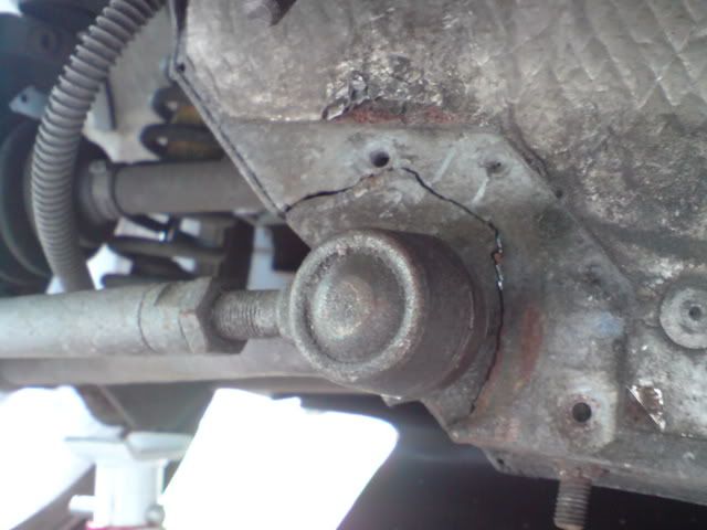

#27 siztenboots
Posted 18 January 2010 - 10:01 AM
courtesy of seloc.shiplo
picture is a bit graphic , but you get the point
