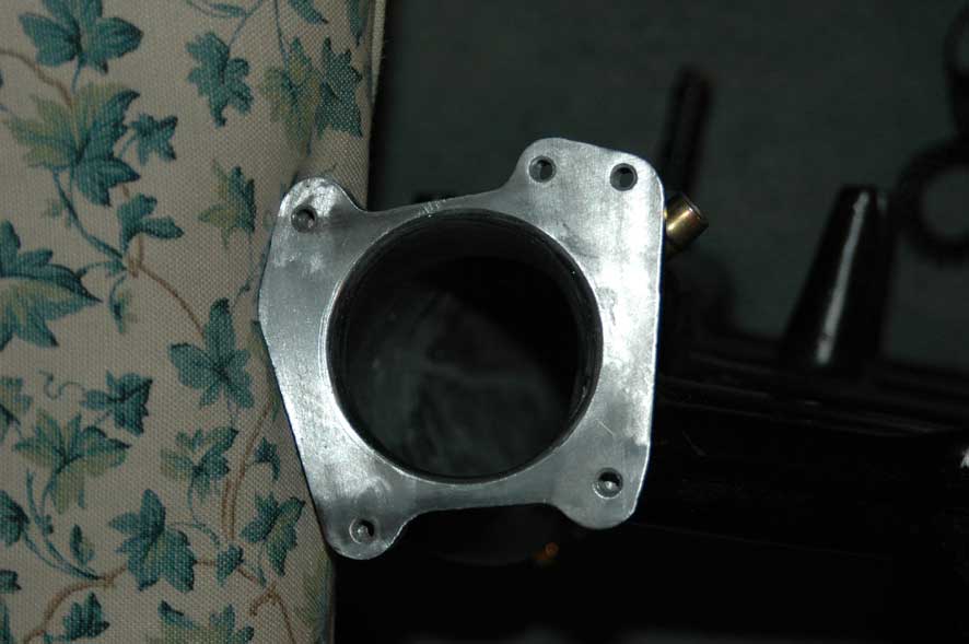

Finally after nearly 2 months from order my 68mm TB is arrived,now i need to port the Dbilas intake from 60mm to 68mm ,need also an adapter flange because the screw position is little different...

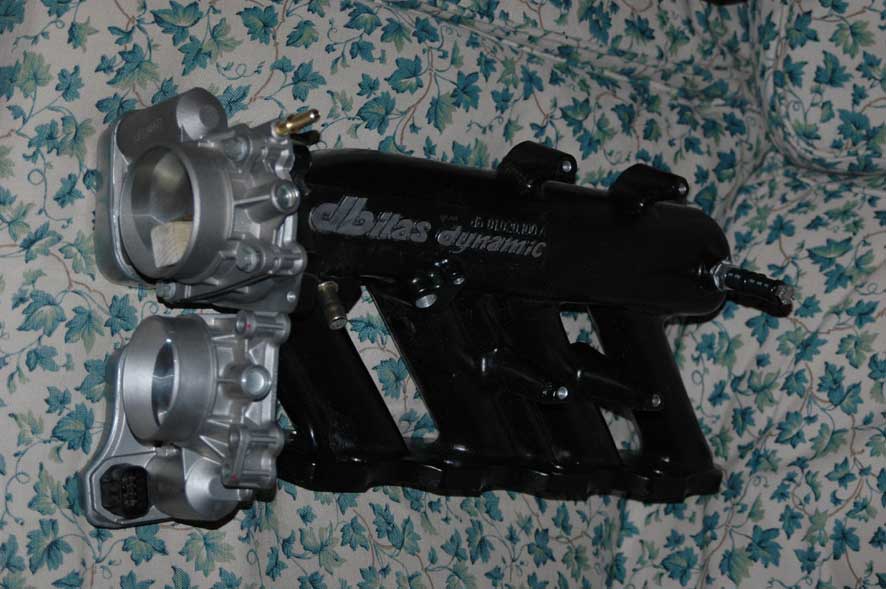

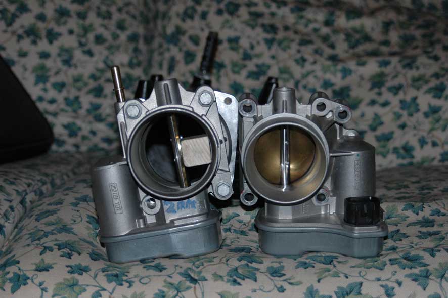

Fitted the 68mm TB on the Dbilas intake,really a fcuking hard job,3 hours of a pro mechanical shop with a CNC grinder + 2 hours by me for finishing,need first a conical grinding (30°) then the hole is not exactly same position as the original so it is needed a re grind only on one side for proper alignement,and most of all there's not enough space on the wall of the intake.... :9mm: :beat:
Now is perfectly fitted but is not easy!!!

Posted 09 February 2006 - 11:33 AM
That looks great!! thumbsup Hope I´ll get my hands on a 68 mm TB soon. :)
Looking good cicastol B) Keep us posted on how she drive!
