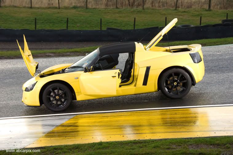

I've been thinking of changing my wheels for sometime now but I prefer the look of my standard wheels to the look of the usual TD Prorace and Speedline alikes (Personal Choice, don't shoot me down) that are available so as much as I appreciate the dynamic reasons for change and the availability of the many different tyre options that come with changing to Elise sizes I've been put off.
Now I know that Thorney offers an Lotus hub mod to use Elise size wheels but again the wheels he's offering IMHO aren't that special.
Now I don't know the details of his mod but if you’re going to that much trouble wouldn't you put some nicer wheels on?
I personally like the 111R/Exige wheels like these in Satin Black
Obviously the PCD is the main problem 4stud not 5.
I've spoken to Ian at EliseParts and asked him about the Bearing packs they sell and he's compared the Elise S2 bearing pack to the VX bearing pack that they also do.
Now apart from the PCD and the connector on the ABS sensor they are identical! And connectors can soon be changed
Offsets can be adjusted with a spacer? I hope!
He even counted the splines 34, same as the Elise and dug out an Elise drive shaft to try in it, perfect fit!
So Four S2 Bearing packs with ABS sensors (But your going to have to mod the connectors yourself when you come to fit them) £296.01
A new set of Elise discs £289.48 (Ultimax S2 Turbo Discs)
Set of Elise wheels of your choosing (I'd go for the 111R wheels as above) £747.50 Upwards
And a set of Elise/Exige rubber £455 upwards.
Total: £1,787.99
Ian was very interested in the whole idea and after some discussion neither of us could see any other reasons why it wouldn't work.
So has anyone done it? Or can anyone else see any potential reasons why it wouldn't work?
Other than the vast cost it almost seems to be too easy so no doubt we've missed something?
I'm sure some of you will take great delight in pulling this idea apart but I'd rather you did it now than when I've wasted £1,800 on otherwise useless garage ornaments!

Couple of points
ABS connectors are a straight swop, no need to cut anything. Eliseparts ones are perfect but you might get them cheaper from a VX dealer as its a astra 4 stud hub
Go for the exige or 240r wheels not the 111r set which are 5.5 wide meaning r- spec tyres will be stretched
Be best budgeting for a set of new pads as well and some suspension to lower the car and make the most of the change
My car was almost useless on the std vx ABS mod, perhaps due to the weight difference. I also fitted a set of lighter alloy belled discs which might have made it worse. Exige abs module worked perfectly for me and combined with the ali bells and 1144 gave lap after lap of great performance
You will need a set of longer wheel bolts, vx ones are too small

As said JawZ got Exige wheels on his Speedster, take a look at his site; >Link<
Now I see them fitted to a VX I want them even more, Hhmm £1,800 isn't that much really! :wub:
