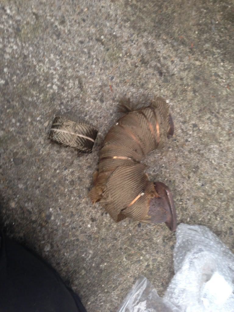

My exhaust had destroyed the packing so I decided to strip off and send to chris tullet to get repacked with the 900 degrees packing instead of the 600 degrees it comes with. While the exhaust was at chris tullet I decided to get them to weld the bung in the exhaust for the wideband.
while it was off I got new nuts and bolts, oem gaskets, exhaust wrap for the u bend as the other stuff was looking tired. I also got a stainless steel exhaust clamp as the last one had rusted away. Also while it was off it had started to look rusty even tho it's stainless steel I didn't like the look so I sanded it down and spayed up with flame proof paint which is good for 900 degrees.
