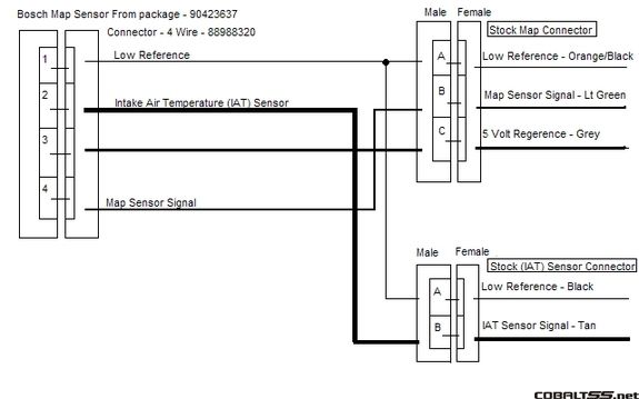

Here is the diagram. It looks like it's taking one wire from it and still using the afr

That pic also still has the standard map sensor on it which also is not needed, I am hoping to get mine up and running with the Tmap Saturday or Monday so will let you no for definite.

Ok no worrys and that will be good if you could let me know. To me it looks like the ITA is still connect and is feeding the new map sensor.

I'm 98% sure that the Tmap sensor is to replace the map sensor and to replace the original air intake sensor otherwise the ECU would get confused with 2 sensors feeding on the same signal wire

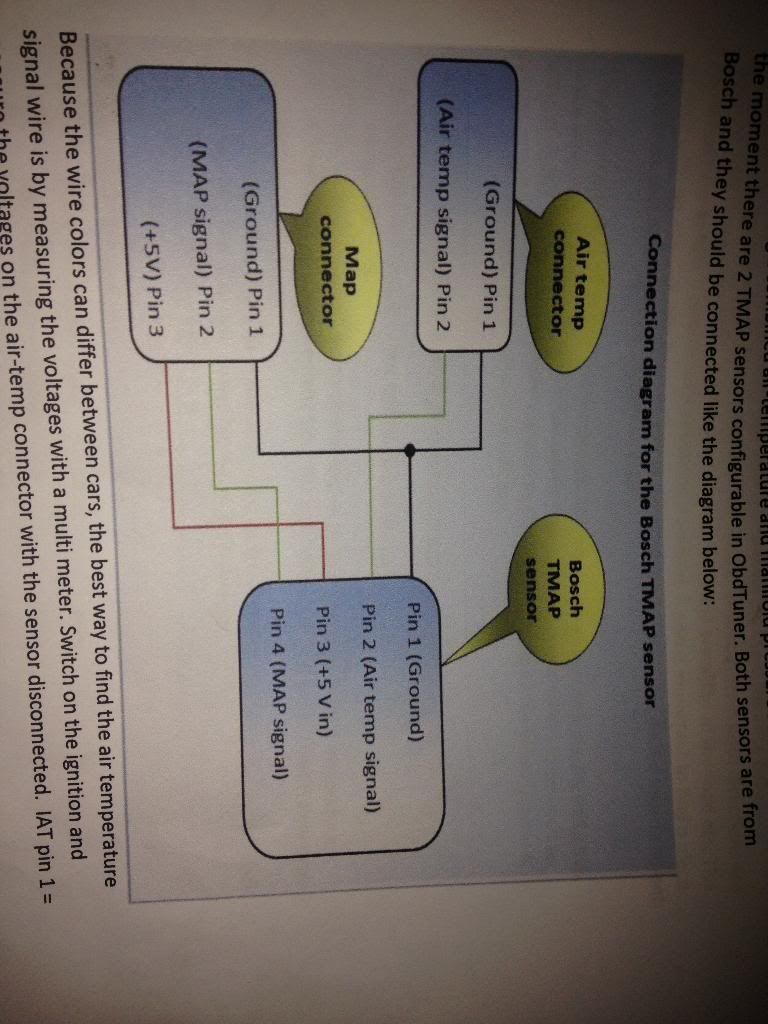

Here is a pic from obd instructions
#408 CHILL Gone DUTCH
Posted 08 March 2014 - 12:45 AM
And you will be telling the ECU that your measuring boosted air temp instead of air temp, In the obd parameters Anyway I will let know for definite when I get mine running

Looking at that pictures it looks like its loses both. Shame as I've only just drilled the hole in my intake.

Yes you don't use your old map or temp sensor.

As lee said mine is working fine without old map sensor and air sensor Confirmed

TMAP replaces both functions of temperature sensor and MAP sensor, clearly the previous items aren't needed.

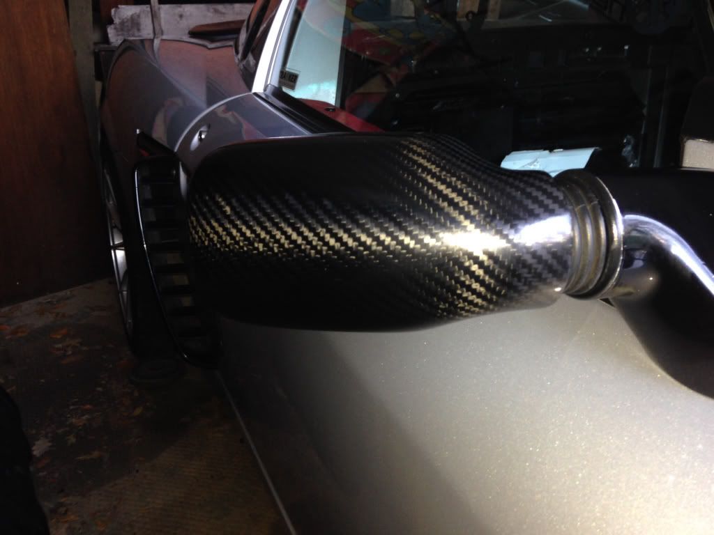

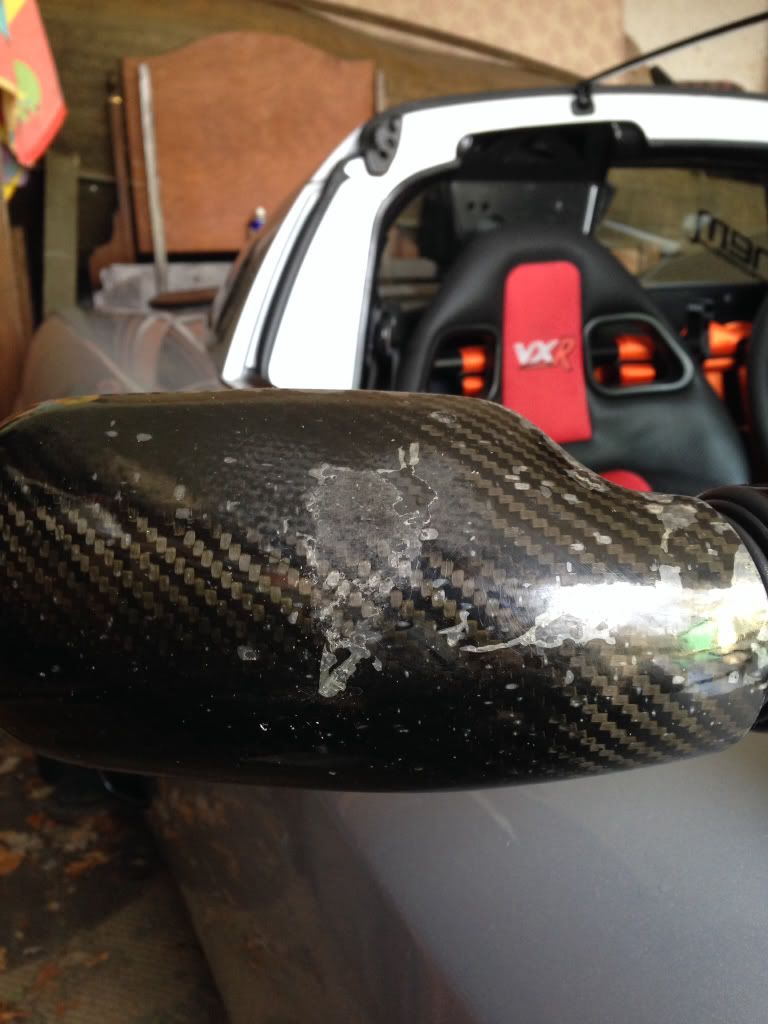

Did a bit more on the vx today. The carbon wing mirrors where looking old and the lacquer was peeling from stone chips. So hours of sanding down and then sprayed with some new lacquer they where looking like new again.

Yeah just a body lacquer so it will be uv protected. The cf dosnt actually need any lacquer and will be fine with out it. I just put it back on to give it the shine.
