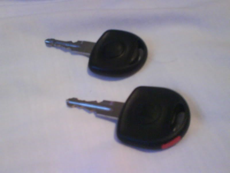

Below shows my old key (top) and a new spare from VXL. Note the red square on the new one, which is the transponder. The old key has the transponder housed inside. Apologies for the poor photo quality, Santa didn't bring me a new camera or phone.

ETA... photo which has disappeared from my previous post

He may be mistaken. The key must have a chip somewhere in it (some aren't always visible) somewhere, or else the car would not start.
Yeah there must be something in it, I'll need to dig out small screwdrivers and check......
Yes there is definately a transponder chip inside the key housing (i missed it at first) but if you look closer holding the keyblade pointing in front of you its on the top left about 4mm long by 2mm wide by 3mm deep..turn the key upside down and give it a little tap and it pops out.
